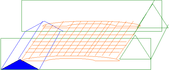

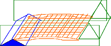

See your point about the rock bucket. Thinking that something like a land plane with slightly higher side walls (not quite unlike a box blade but longer) and the hardware cloth for sifting. still would "clog up- just not sure how quickly.
If you can see it.... the blue triangle would be the cutting bar like on a land plane. The orange is the sifting screen/hardware cloth but set in an arch. the green is the side walls and end "trap" for larger debris. In theory, sand gets forced up and over cutter bar (could even be a very fine screening at this point too) the sand/debris moves up and over the forward curve, hopefully tumbling and breaking apart compacted material. larger/unbreakable material continues to be pushed further back until it gets to the 'trap".
Not a perfect design- just some ideas
What debris is the biggest problem?
