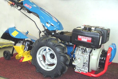

Anyone have a BCS 853 with a Yanmar Diesel?
I have a gas 749 that it great but I wonder about the diesel, especially since I got a diesel compact utility tractor for some heavy landscaping -it’s been great.
I have read numerous threads re the difference between the engine types -including hard starting in the cold, which is definitely a consideration- but haven’t seen much about the Yanmar powered units specifically. Anyone have any comments?
Thanks
SG

You are asking about this,
FWIW, the price is a bit high, even for this old ad. I wouldn't want to see the price today,

I was under the impression that they came with a Hatch diesel, not Yanmar.
Whatever they came with, the price of the diesel would increase the cost substantially.
You could always retrofit however. I know Hatch sells their single cylinder diesels even today. Not sure about Yanmar however.
/ BCS with Yanmar Diesel? #4
You can retrofit a diesel pretty easily. I have run both and for a 2 wheel tractor it's great but not worth swapping a running gas engine for.

There are Yanmar clones selling pretty cheap, but anyone buying one of those should probably be mechanically inclined and prepared to work on them sooner or later...

I suspect BCS dropped the diesel motor simply because of the cost. The Honda motor is much less expensive and reflects in the asking price. Having said that and my bad experience with Honda engines, I would never purchase anything that is Honda powered.

I monitor the air cooled diesel engine thread too. I have like a zillion manuals for them.
Some clones are better than others, but their fit/form/function is lacking a good deal to have miss timing or too much soot or air sucked into with the fuel. Clone gaskets are the worse. LOL

Both Yanmar and the 3rd party repower/rebuilt Yanmar engines are sold separately from any machine too.

Or just get a Yanmar 2-wheel tractor and still use the BCS attachments.

thanks for the replies, the unit I’m looking at is very lightly used and the price is really excellent
I’m a pretty limited mechanic for things beyond general maintenance and adjustments but my nephew is a diesel mechanic and was encouraging when I asked him about trying one
I’m mostly wondering whether people like them or find they are not as useful for some applications such as mowing

If I came around a lightly used BCS/yanmar at an excellent price, I'd be inclined to buy it.
The gas engine models were less expensive to buy and probably lighter. I'm not sure that any diesel engine option is now available on new BCS. Didn't look at all the options, but what I did see was a choice between Honda gas or Briggs Vangard gas.
