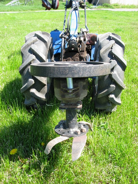

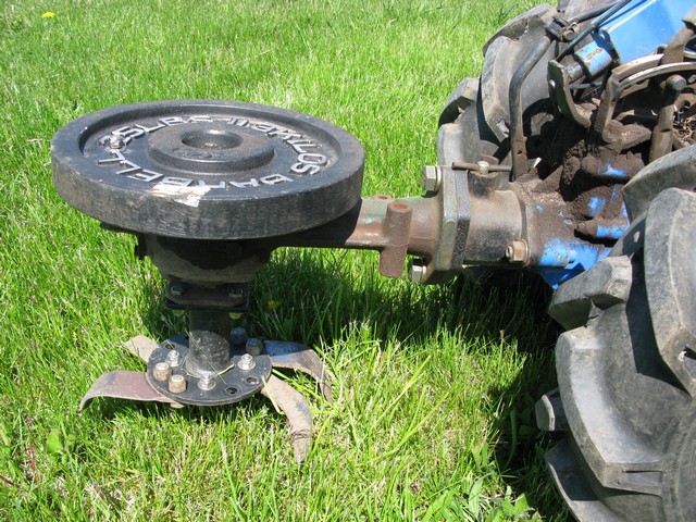

   / BCS Tiller Shear Bolt/Pin? #5
I was using an old Mainline tiller box on my 715 the other day, hit a tree root and found that it had a shear shaft:eek: They were only 3/4" on these old models.
I turned it into a vertical cultivator, works great.
Rob
