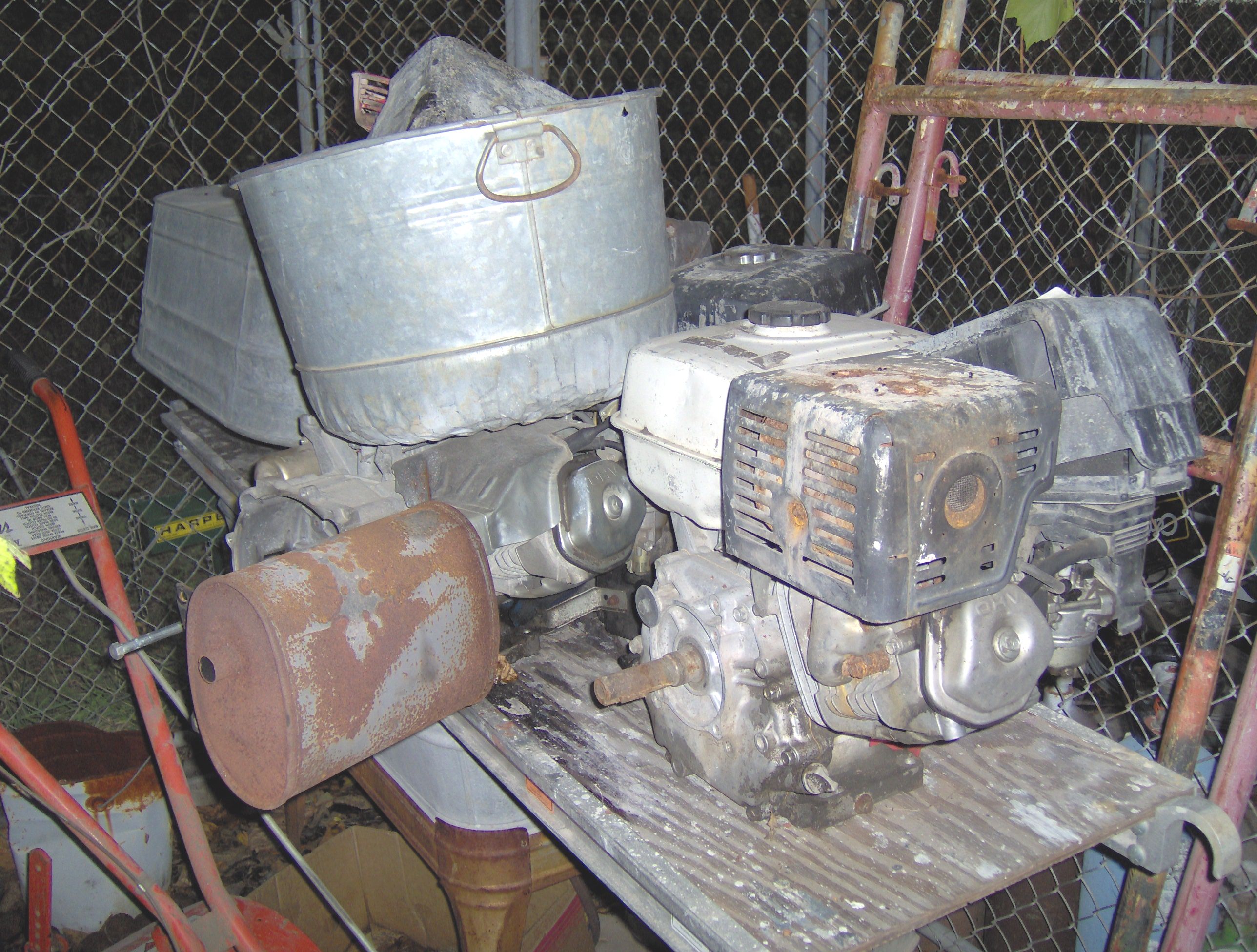

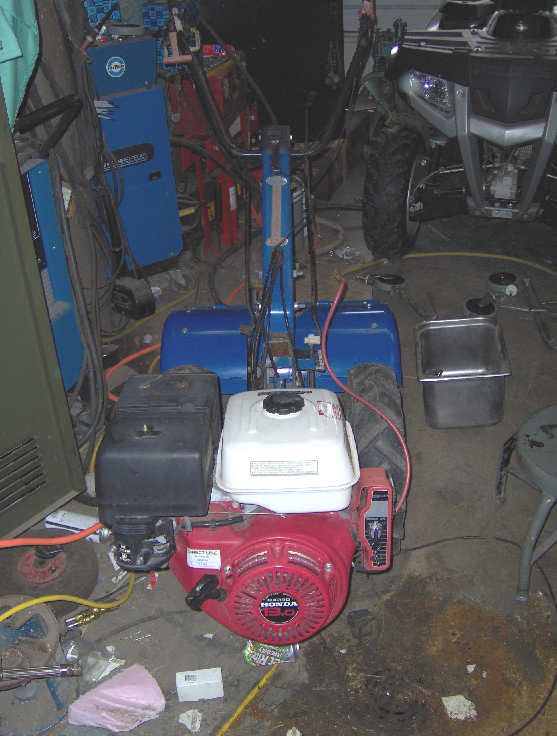

I have found with the rich soil I have here that when tilling the handle bars are too low. This is when the adjustment is all the way up. Has anyone else ever had this problem? After a good close look and a bit of studing I can drill a new set of holes in the base of the handle bar frame (Factory there is a slotted hole for some adjustment) to raise the whole handle bar unit or I can cut off the gear (this is at the base of the handle bars)that allows the handle bars to adjust and reweld them back at a better angle for my use. Anyone have a better or another idea? Also has anyone added a battery bracket? would anyone have a used one of be able to send me some picture of theirs? Paul@BackYardProduce.com or post them here!

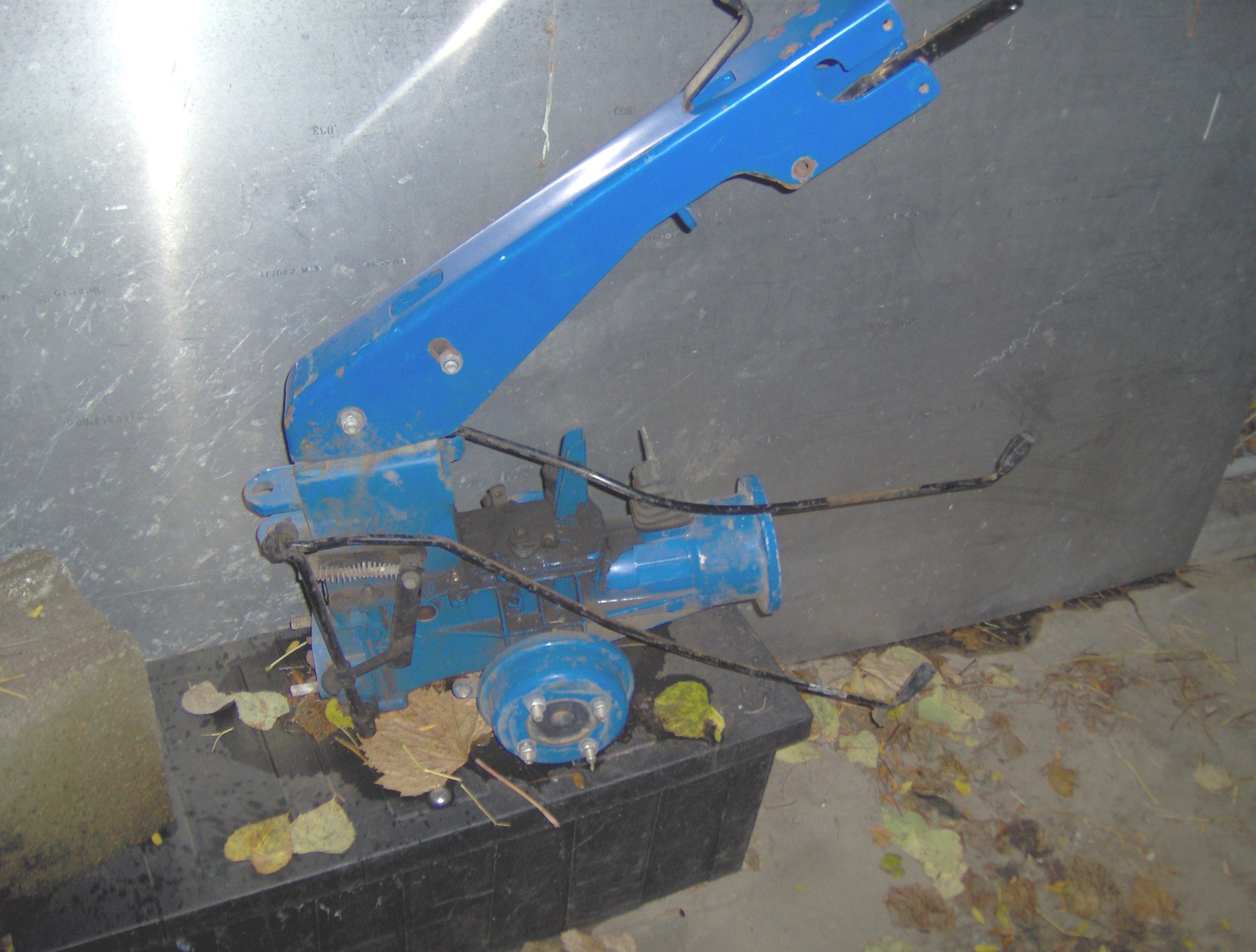

Some good pictures of the battery box be great! The BCS 830 has been adjusted to the limit and is still too low for me. I till preseason with a Howard rotatavator on my New Holland tractor and I can bury it to about 12"-16". I till between the rows with the BCS and it will easy go 6-8" deep. I spend most of my time and effort lifting the tiller so it will gain traction with the tires and move forward. Please do not suggest wheel weights as it is the tine guard that is plowing the dirt and slowing up the tiller. The best fix will be to rework a tiller attachment and enlarge the diameter of the tiller but that is better saved for another winter project.
Above are the points I would like to re-weld or drill to lift the handle bars. Any thoughts?

Another hole wouldn't hurt anything. I'd drill the hole and see if you're happy with it. That'd be a little less permanent than cutting off the handlebars and welding them on different.
Here are the pics of the battery box. It mounts on four bolts at the transmission housing and the bracket that holds the clutch cable. It'll make it a bear to adjust the clutch, but that's stock.

The easiest thing for you to do would be to just drill another set of holes below the adjusting slot.
