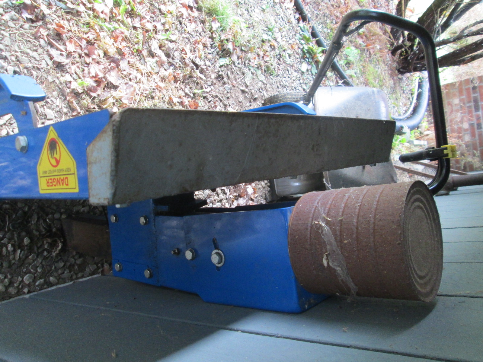

I can't imagine what it would take to break those shoulder bolts but I guess anything's possible. When I first bought mine years ago I replaced the rear rubber flap with a steel cover. Makes me feel a lot better after reading a few of these horror stories. Mower is standing upright with pto hitch under a can in the picture. (Picture should be rotated 90 degrees counterclockwise.) I never had anything "flow" out under the back so no performance issues for me.

Rocks, logs and stumps are what broke those bolts on mine, if I had to guess.
I thought about using a steel "flap" like yours, but I do an awful lot of backing and I'm pretty sure it would get over flexed and either bent or broken. How thick is that steel?

The steel is 7/64. As you can see, I welded little sides on, so it's not just a bent piece of steel. I have never caught anything on it backing up. (That I noticed at least.) But this thing is not going to bend with my 739 pulling on it. The wheels are going to spin way before anything bends. And even if you have twice as much traction it's not going to bend. I would say that you're not going to be able to damage it with a two wheel tractor. If you're worried about it use something thicker and bolt the little sides to the sides of the mower also.
I cut brush and wild rose bushes with mine so it's not like a whole lot of throughput is happening. I just get on top of the stuff to chop it up a little. The BCS video shows the guy mowing corn. Nothing like that for me but I honestly don't think my guard would make much difference. Hard to say.
