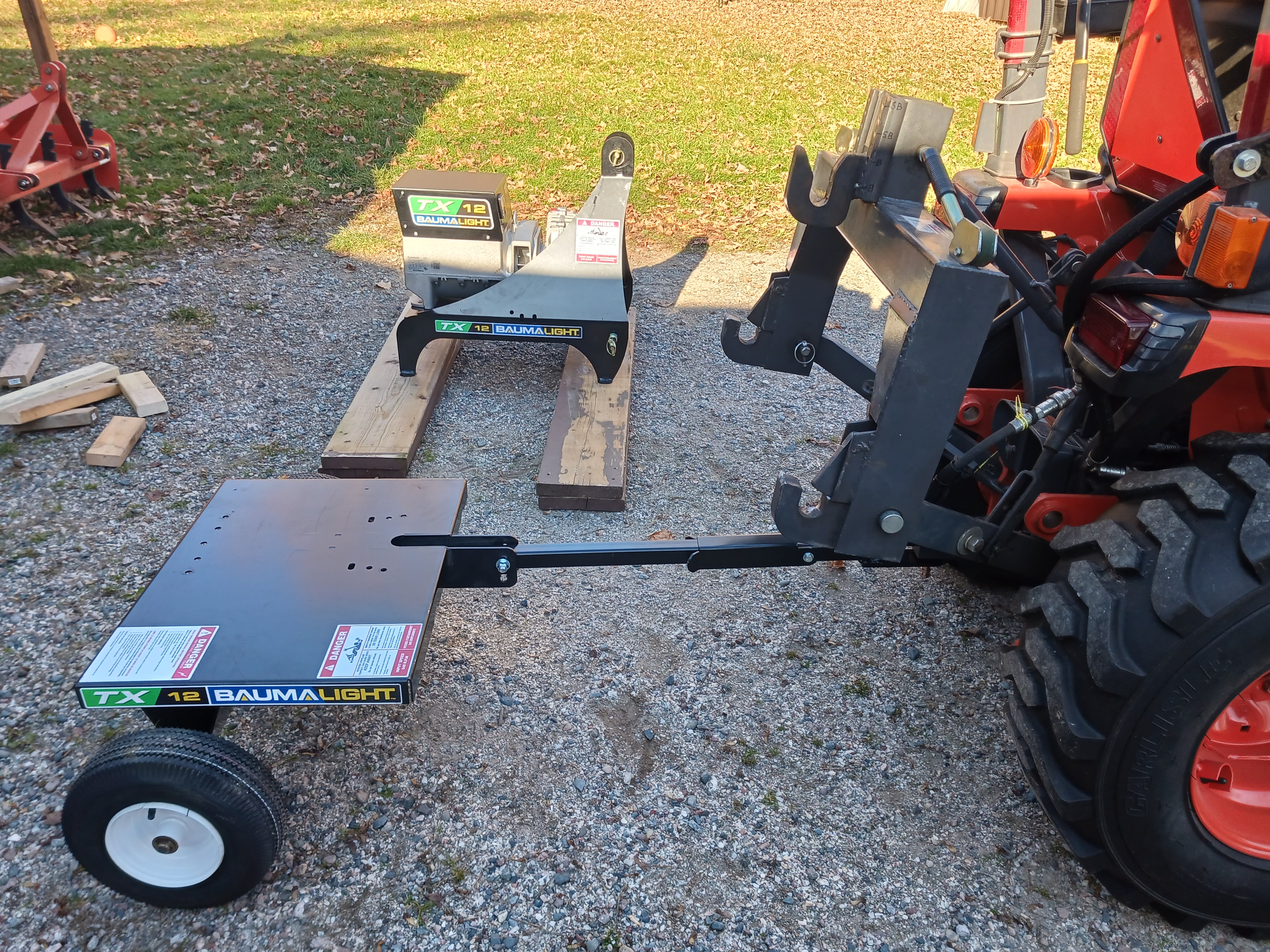

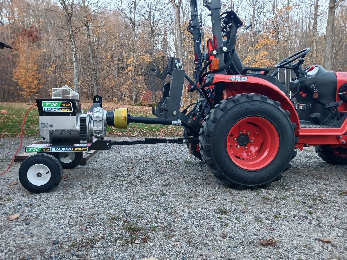

So yesterday I finally tried my new Baumalight TX12 PTO generator for the first time.
Also ended up taking it back off the 3 point hitch cradle and put it back on the trailer because the cradle is not quick hitch compatible, even with my adjustable top hook. So I quickly realized it was going to be a major pain every time I need to switch between generator and my implements.
But now my question to those of you that have one, when setting my throttle and trying to get the voltage meter to 120 volts...it never stops fluctuating. If I set my throttle so it does not exceed 120, it will bounce between 110/120 constantly. Is this normal?
I only had a very light load on it, and my driveline was pretty straight and no vibration.

Uhmm. I don't have a BaumaLight, but my Winco volt meter stays consistent under no load, or a consistent load. You may want to get one of those plug in watt meters that also measure frequency. I use a Kill A Watt meter and set the generator to 60hz.
