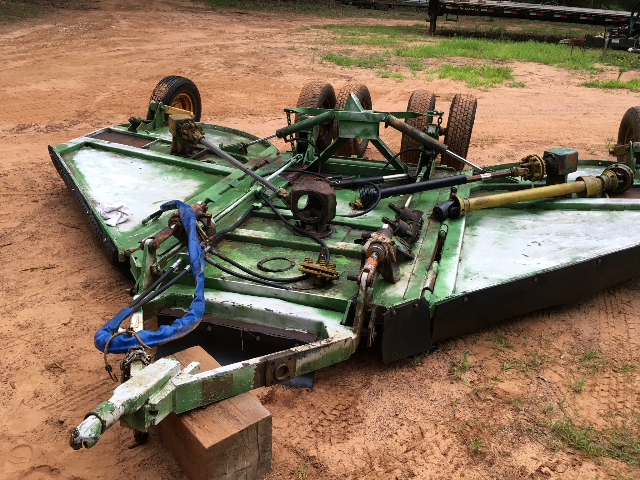

I bought this at an auction a few years ago with no markings or plates. The splitter gearbox finally gave out and I can't find parts for it. The gearbox runs the center blade directly under gearbox. Can anyone help me. I'm image.jpeg

Don't know the mower, but you should contact DN Equipment in Ohio for gearbox replacement or parts. Google to get contact info.
Gearbox should have some casting #'s on it that will help in the brand identification of the box or the mower. If you want to post, that could help too.

We own a Bush Hog 220 (obselete) with a similar looking center gear box. We found a manual for a 2720 which looks to have a similar gear box.
/ Batwing indentification help #5
We own a Bush Hog 220 (obselete) with a similar looking center gear box. We found a manual for a 2720 which looks to have a similar gear box. What caused yours to go out? ours had a leaking bottom seal that we had to replace.

I will try that. I didn't know the center one was leaking from the bottom. It had oil in it but I guess not enough or it may have been damaged when I bought it and finally failed - not sure but thanks for input.

I sent photos to Bush Hog and they said it is not their brand mower. Now what?
/ Batwing indentification help #8
The guy up the road has a ford mower and the lifting looks just like yours. Might check there.

I can't find anything on the web about a Ford flex wing mower but I'm guessing someone made it for them. You didn't happen to see a model on it?

Is that not a id tag on the front lower part of the gear box, that should give you the model number of the gear box and with that you should be able to find the parts you need.
This is a Omni box like the one you have.

I realize your mower does not look exactly like my bushhog, but thought the center gear box might work.
Also, mine is a 20' batwing, so the gear box might be heavier if yours is a 15'.
Hear is a link to a gear box break down. It will print out 3 pages. Hope this might help.

I found out that it is a Terrain King TK-15. I also found the part numbers I need but they are no longer available. Actually I need 2 gears and only 1 is obsolete.
