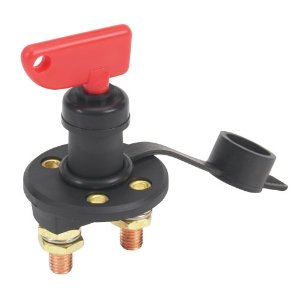

Does anyone use a Battery Disconnect on their tractor / Bobcat, etc.??
If so, have you found it to be helpful? And, would you put it on the negative or positive side of the battery cable?
I guess if you have clocks and radios that need power for memory, it's not a good thing.
Was curious if it helped cause less drain on battery, especially if you only use the equipment a couple times a month.
Would it make batteries last longer?? Less corrosion on the terminal?
Here's an example of one kind of switch......

I used one on my Model A Ford, on the non- grounded lead. ( Mod. A has + ground) That model car had a problem with the Gen relay sticking and causing engine fires.
The switch worked well. If I was going to store a vehicle for a while, I would install one. It would eliminate any drain problems. I don't think it would have any effect on corrosion or longevity.

Battery disconnect will not harm any of the controllers. if ther is a radio with clock, then clock will have to be reset each time. Doesn't make much difference which cable you disconnect, either will will serve the pupose. Keep in mind this will NOT quarantee a fully charged battery when you come back to it a month or 2 later, all batteries will discharge with time without having anything connect - even new on the shelf will loose some charge over time. Hotter the ambient temperature around the battery the faster it discharges.

I use one in a hot rod and have used them in tractors years ago that were marginal and I feared the fire risk. They work just fine but there aren't enough electrical options on tractors to cause any problems even with infrequest use. Today, I have a tractor that rarely gets used and never a problem--always starts fine. Mine was on the positive cable and it did not corrode.
i'll add that before winter every year I charge all my batteries to help them survive the cold. So, yes, disconnects work but no thay really aren't needed to control a nearly insignificant loss.

Put one on the ground of my tractor right at the battery. No chance of any inadvertant electrical fires

I am not the expert here, but I believe that in boats, and in household wiring, you always place the switch on the power, not the ground side. The logic being that you want to stop the amp flow before it gets the wiring and components of the circuit. You can get accidental groundings of live circuits even with a switch on the ground side.
   / Battery disconnect switches on batteries.... #8
With the negative cable removed or switched off, there can not be current flow anywhere when you ground anything to frame ground, even the positive battery terminal.

My 7753 Bobcat only gets used once every couple months. Every time it gets used I am cleaning the positive terminal because it is covered with corrosion. The positive battery cable terminal is made of brass. More than half of it has been eaten away while the machine is just setting. I have been wondering if the BOSS system is drawing electricity and if stopping that electricity flow would stop the corrosion. Then I wonder if shutting off power to the BOSS system for long periods of time would damage it.
Well, I put the battery disconnect in my Bobcat 763 over two years ago now. (on the positive side cable)
I switch it off every time I'm done using it. Which is about 1-2 times a month. Just home use.
No corrosion on the battery and I've never even had to charge up the battery at all during that time.
No radio or clock in the 763 that would require some juice....
So far so good.
