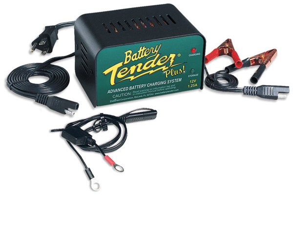

I just bought an older 7x12 dump trailer. It belonged to a construction company and is a heavy duty trailer. The battery is located near the front corner of the trailer and sits under the bed. To charge the battery I have to raise the bed a little so it is easy to hook up the charger. It appears I could possibly get down on the ground and reach up to hook up the cables but would be very difficult and this body is getting too old to do it that way.
Has anyone come up with a solution that might have some type of cables that stay connected to the battery poles and are attached to the tongue or somewhere easy to get to so the charger can be connected w/o having to raise the bed?

You can buy 2 pin charger pigtails pretty cheap. This pic shows one in the foreground. This particular charger also has the clips that will plug into the same cord from the charger.
Get yourself a charger with that type of cord and buy multiple pigtails. I've got them on 3 motorcycles and a couple of riding mowers so that I don't have to remove the batteries during the off season. Although I don't have the brand shown, this type of charger is fairly inexpensive so I have a couple to shuttle back & forth among the batteries.
Fortunately for me, my trailer is set up similar to what kenmac describes. I just leave it plugged in all the time so that it's ready to go. Same with my trailer type man lift with built in charger. Not sure if the factory 7 pin on my truck has power to the center pin or not, but it doesn't really matter to me. Like Dave says, if the trailer sits for a period of time and the battery discharges, I don't think power from the truck is going to bring it back in a reasonable amount of time.
