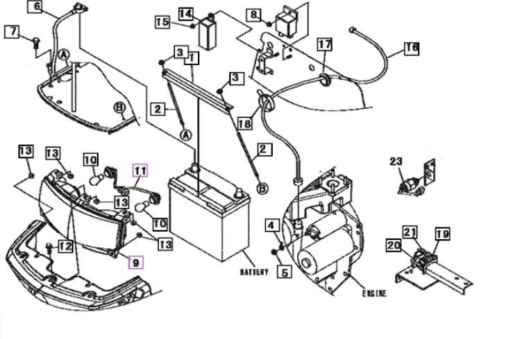

I need a new battery for my 2516.
Today I'm trying to figure out how to access the battery "compartment". I don't find any help in the tractor's manual.
Do I need to remove the grille and headlights? I see a couple of wing nuts under the hood at the front -- do I just loosen those and somehow pull the front of the machine off?

I don't have that model, but I have seen it done on YouTube...[ I have passionately been reading and looking at all 2516 stuff I can find ] Move grill guard forward, then the removal of those two wing nuts lets you remove the headlight assembly to access the battery. I am thinking of buying a 2516 HST to add to my fleet, but don't have on in my barn as we speak..... Good luck, Jerry...!!!!

Just undo the two thumb screws, tip the grill asmbly forward, twist/pop out the headlight wires/bulbs, and lift the whole grill assembly up and out. Easy.
Thanks, Old One....!!!! Now I don't have to spend endless hours watching videos of 1526's on the YouTube.... !!!!! [ now I can do it cuz I want to... :) ]
