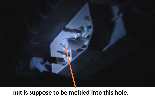

--upon doing above fix, i guess i messed up the screw, that holds the wiring harness plug, to the ignition switch, the result, the nut molded into the ignition switch pulled out and held tight to the screw. resulting in the plug not fully seated.... i am almost positive i did not over tighten. but *shrugs* to late now.

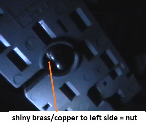

last and final frustration. trying to get the nut off the wiring harness plug that goes to the ignition switch.
already tried needle nose smallest i have, and not small enough, tried flat head screw drivers, some little picks, bottle of beer cap remover, snap ring pliers with long straight ends.
not sure if i can even find small enough and long enough needle nose pliers some place,
might try a small drill bit and drill me a hole. and hope bit does not break, when i put wrench to bolt head. (using drill bit to pry against)
any suggestions to get the nut off?

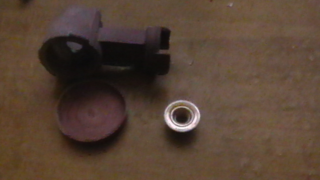

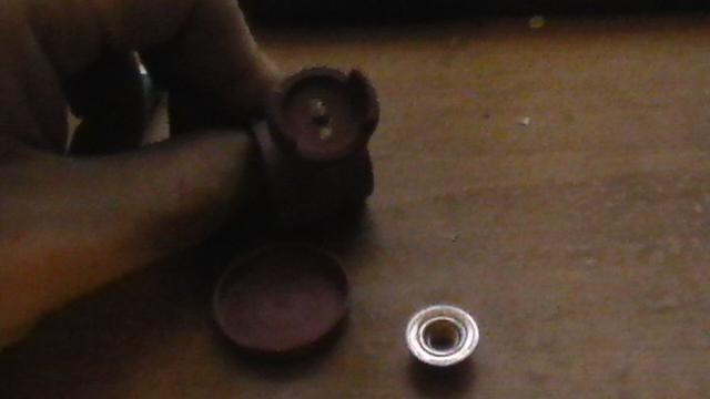

after repairing battery terminal connection and wire right at the battery. begin wiggling wires around....and wire on alternator fell completely off. there is a little flat disc with some threads sticking off of it. that is suppose to be on the end of the "alternator terminal extension". and the little soldering looks to have given way.
nearly 10 bucks for the little item with shipping. :/
time to find some ring terminals and chunk of wire and make my own.
