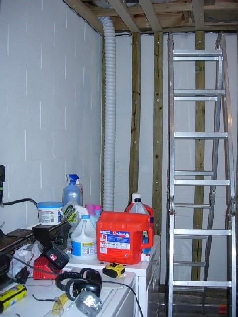

Setup: Utility room going to be made into a full bath. It's already plumbed for shower/toilet/sink.
Room is roughly 16' wide by 14' deep with 9' ceilings.
Washer/dryer are on back wall, just offset to the right of being in the middle. Dryer exaust vent from the dryer itself (rear discharge from dryer) goes to the right on the ground maybe 4' and then goes up to the ceiling where it discharges outside. (this is block wall and is all under grade so had to go UP to get it outside)
Ok, wife bought exhaust fan for the bathroom. This thing has an 8", yes EIGHT inch outlet /forums/images/graemlins/shocked.gif
I might see if I can step it down the the same size the dryer uses (I think it's either 4" or 6"?)
None the less, here's my thoughts
Take out the plastic (with wire), dryer vent and replace it with hard ductwork. Put the bath vent in and step it down to the same size used for the dryer.
Bath vent will be near middle of room, perhaps a bit skewed to the back/left side. Anyways, take the pipe from the BATH vent to the back wall, cut it 90 degrees to the right to run parallel along the wall the dryer is on. When the bath vent meets up with the dryer vent coming up from the floor, install a "T" there and allow BOTH items to blow out the same flapper on the outside of the house.
Any thoughts on why I might NOT want to do this??
Any thoughts are appreciated!

The air will follow the path of least resistance - and that may mean that either the dryer or vent fan may exhaust out the other appliance's duct back into the room, rather than to the outside. You could use backflow preventors in each line, but it just isn't the right way to do things. They should have separate exhaust ducts.
Any bath vent fan that has an 8" duct is a monster. You may have make-up air-flow problems as the bath fan may pull air back through the dryer vent. Again, this may be decreased by backflow preventors, but it could be a problem. Is the bath fan oversized for the room? Typically bath fans are sized to allow 8 changes of air an hour. Multiply room length x width x height (in feet). Divide this number by 8 to get roughly number of cubic feet per minute you fan should pull.
Consider putting the bath vent fan on a rotatory timer. Intermatic makes a timer that fits within a standard box with a switch plate, and can be set for 5 - 60 minutes. Very handy in clearing a bathroom out "after-the-fact."

The make-up air is going to be a problem. The bath fan will suck air through the dryer, since the doors probably don't leak enough air from the rest of the house to make up for what's being exhausted. However, if you can restrict the outflow of the big fan you will reduce its cfm rating, without hurting the fan any. (careful of duct whistling, though). EFI has a couple of products you might be interested in. One is a switch that runs the fan and light separately, so the fan can run for a (preset) time after you shut off the light when you leave, very helpful. Another is a dryer vent termination that shuts tighter than the usual hood/flap, yet opens enough so there's no restrictions. I'm pretty sure it's not rated against backdrafting, but is probably better than a flap. BTW, if the dryer is running and someone starts the non-restricted 8" fan, you'll probably backdraft even the lint screen and end up with a mess. Good luck getting in charge of the engineering here. EFI site is www.efi.org Fan switch is 5500.501, termination is 4510.51 This is a good place for energy efficient products.

here is pic of the dryer vent. I can NOT vent it out any lower as it's all below grade. I'm going to swap out the flexible stuff for some hard ductwork.
