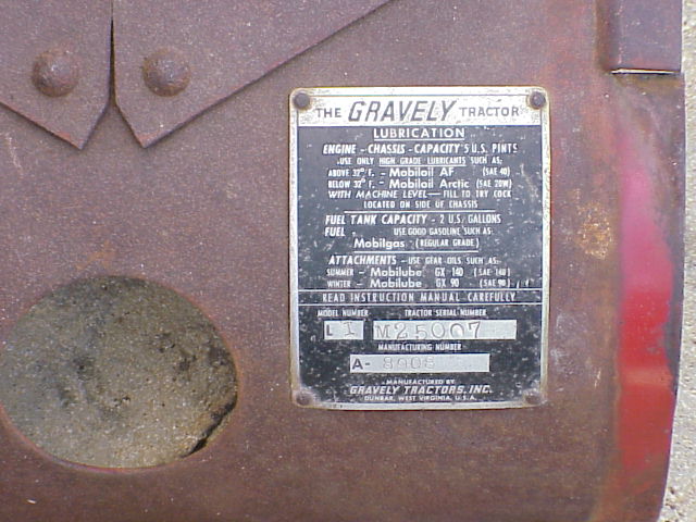

Multi-weight lubes are very common today, and there are many of them. So it's not really practical to list all the numbers. A viscosity vs. temperature chart is nice, but many folks don't understand them. So if you were to list something like 90 weight, it should be enough to differentiate between engine oil and hypoid axle & transmission lube. It's not the best system, but it works.
FYI - 75W-90, 80W-90, 85W-90, are typically used in northern climates. The multi-lubes that go to 140 are typically for southern climates or desert regions. An 85W-140 will cover both regions and is fine to use.
Except that if you check some older equipment built up north, you'll find 140wt was speced for it. It was due to heat buildup in the summer. Winter was 90wt.
And I do agree, the 85w-140 is fine unless you have brass gears. Then you need to make sure the oil is sulpher free.
