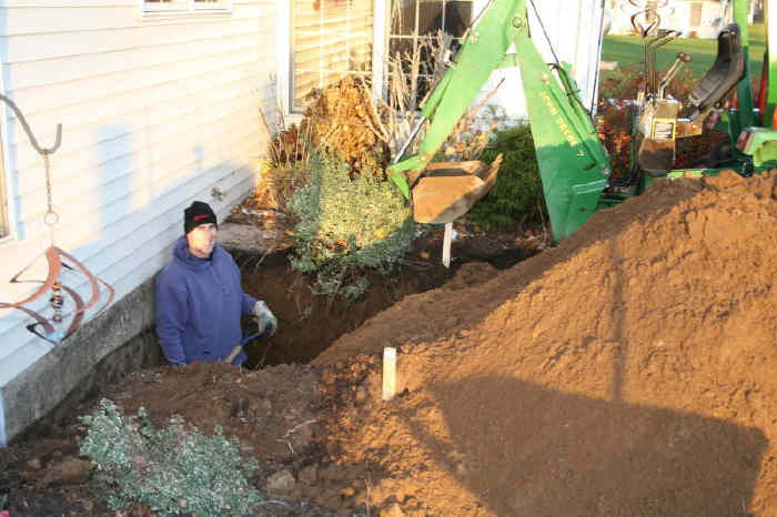

A friend of mine solicited my help in putting in a couple of basement windows. I had the backhoe and he just bought a very slick saw. Details on that to follow.
Started at daybreak digging the window well /forums/images/graemlins/smile.gif
   / Basement Windows
#2
This is Mark, down in the hole. Note that there is plenty of energy and smiles at this time in the day /forums/images/graemlins/smile.gif

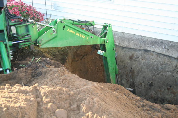

   / Basement Windows
View from the operators station /forums/images/graemlins/smile.gif

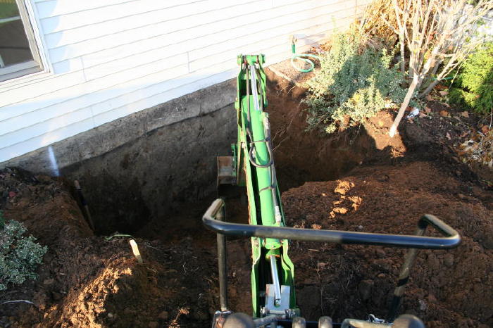

   / Basement Windows
Digging deep /forums/images/graemlins/smile.gif

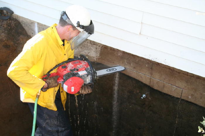

   / Basement Windows
OK, here's Mark with the new saw. He checked into renting concrete cutting saws (circular saws) and hiring it done. It was cost effective for him to purchase this saw and do his two windows, two at his dad's then sell it. Even without selling it he's better off. It was something around $1300 and is a chain saw with diamond teeth. The chain alone is $300 but he was told he could get the four windows cut with only 75% of the chain.
The unit is Italian made by ICS and has a hollow bar through which water runs. It hooks up to a garden hose. Very messy, but very effective. You score your cut line with the nose of the bar. Then go over it again to a depth of two inches. Then make a plunge cut and follow the score line. Big advantage is no overcutting necessary to make the corners. His windows were four feet square and the four sides took a total of about an hour to cut. He said it was pretty tiring holding the saw, particularly on the horizontal cuts /forums/images/graemlins/smile.gif

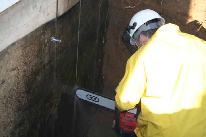

   / Basement Windows
Vertical scoring cut /forums/images/graemlins/smile.gif

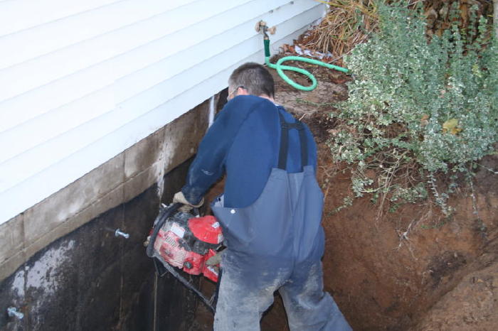

   / Basement Windows
The side cuts were last. Before finishing, 1/4 inch steel bars were placed in the cuts to keep the slab from pinching the saw /forums/images/graemlins/smile.gif
