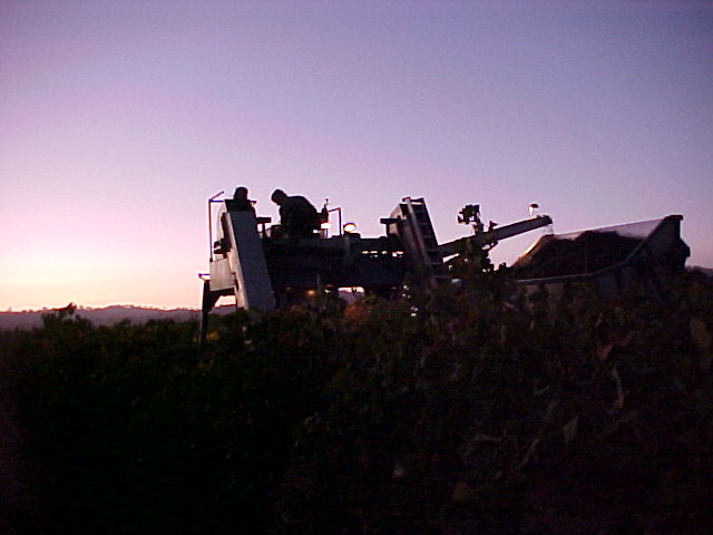

Finally finished my 2009 grape harvest (Grenache) in the Barossa Valley, South Australia on Friday.
I've been busy with other urgent work and haven't yet cleaned all the equipment and put it away.
Prior to Easter my son and daughter came out while I was picking Merlot and took some pics for a school project. As I never get the chance to take photos I thought I'd share some of theirs with you.

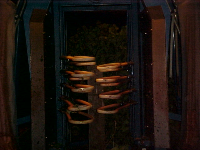

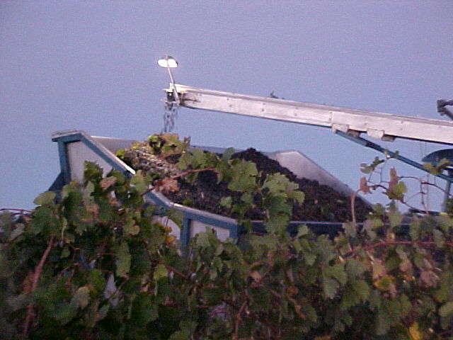

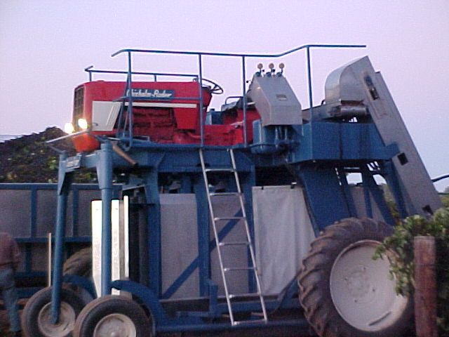

Cool pics Allen, thanks. I've seen these machines around our area and often wondered how they work. Can you describe it? Are these wine grapes?
   / Barossa Valley Grape Harvest Pics
Yes. they're wine grapes, that's all I grow.
The hydraulic motor driven picking head has 4 eccentrics pivoting the 4 beater posts a few degrees.
The nylon bow rods (third pic) beat the vines at about 460 strokes per minute, moving about 3 - 4" at the ends.
The berries and many entire bunches fall onto about 18 spring return catcher plates each side which are angled and pivot open around vine trunks and posts.
The angle of the catchers and the pivoting around vines causes the grapes to slide off to each side onto conveyor belts (also hydraulic motors driven).
At the end of the No. 2 belts the grapes and leaves pass under suction fans which suck out most leaves.
From there the grapes are conveyed to the top and across to a tote bin.
This 36 year old machine has an International 74 Hydro driving the rear wheels via a oil immersed chain drive down each side, so it doesn't raise or level like modern machines.
There is a 3 stage hydraulic pump driven from the 540 pto shaft to power the picking head conveyors and fans.
The No 1 (catcher conveyors) raise/lower and discharge conveyor raise/lower and slew are controlled by a triple remote valve where the normal IH remote valve was mounted and is supplied by the standard 10 GPM hydraulic pump fitted to all IH 74 series tractors of the era.
