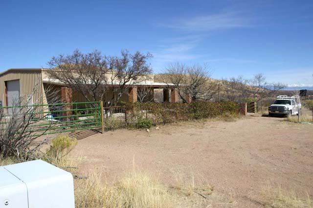

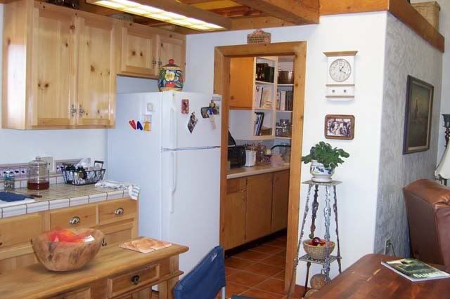

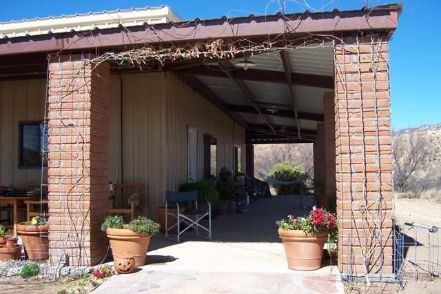

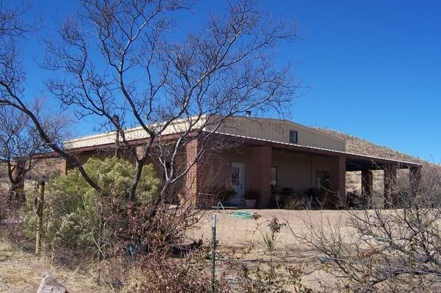

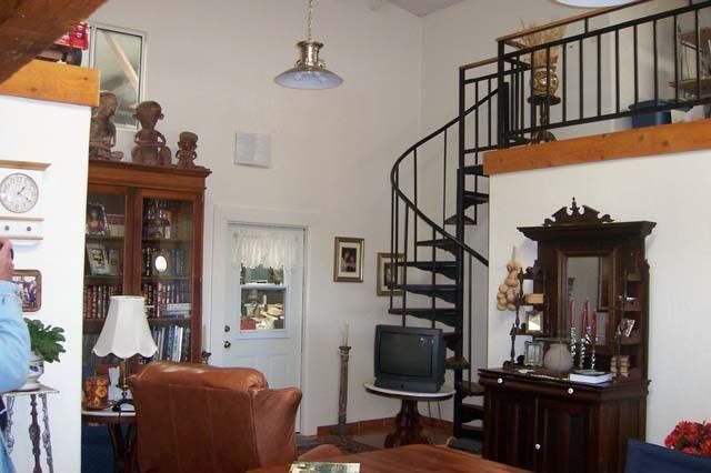

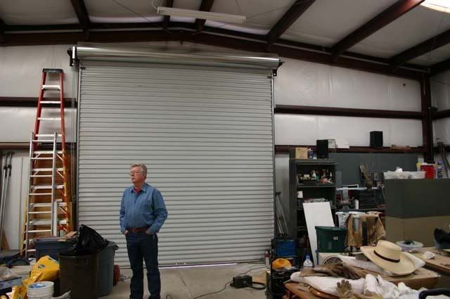

Barn belongs to my cousin 40x40 (I think) steel building with apt inside. Click for larger.
