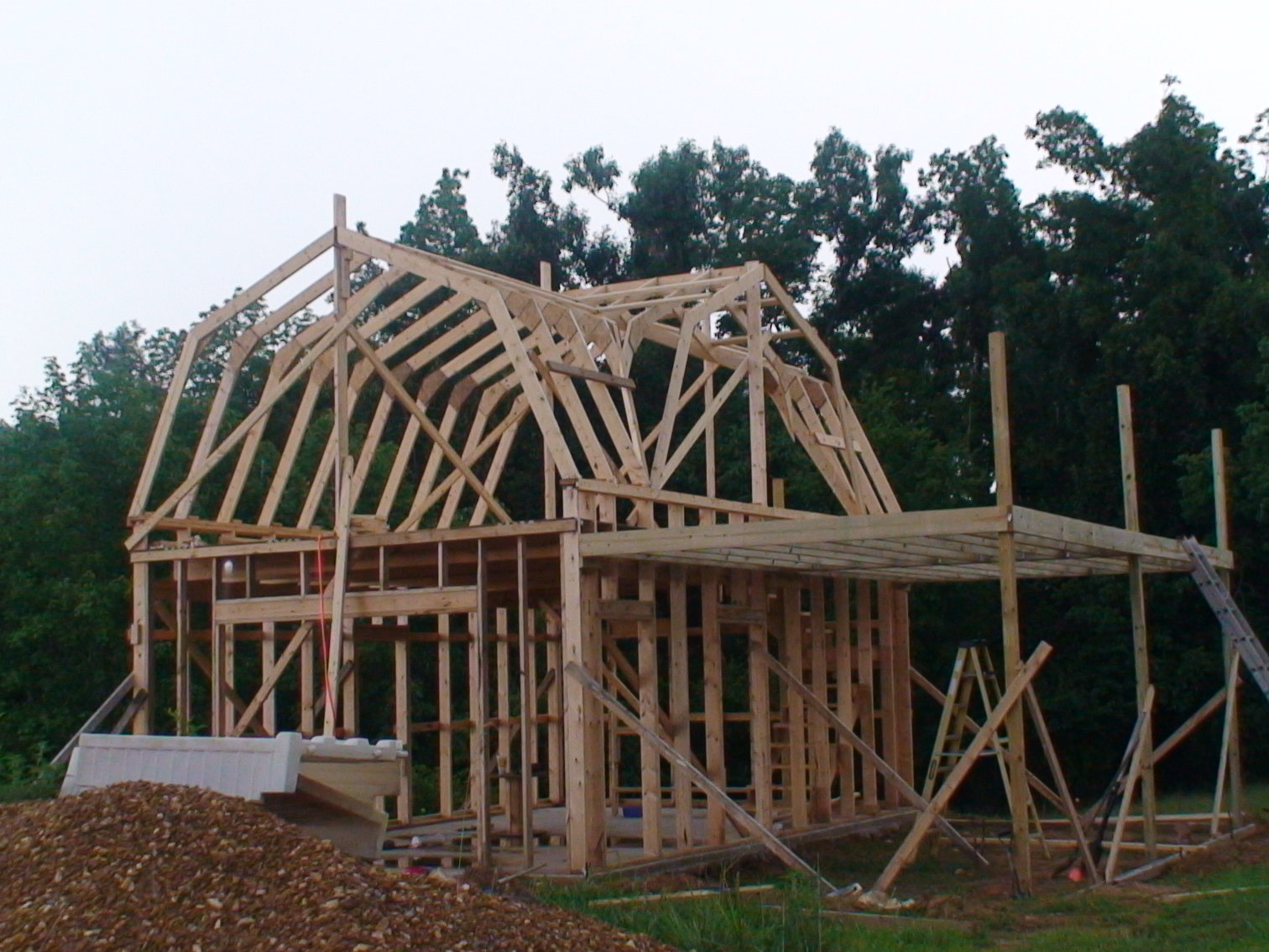

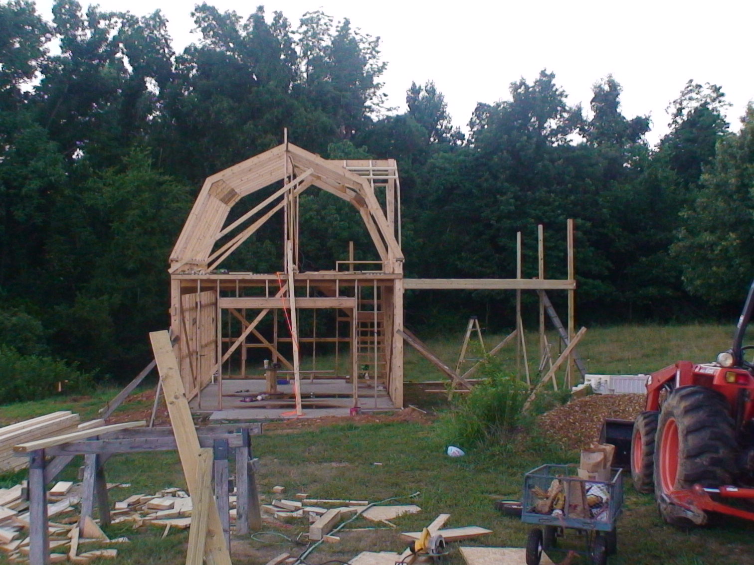

I built some gambrel rafters spanning 16' as shown on the attached pictures. They do meet at a ridge board, so they are rafters and not true trusses, but I did it that way so that I had more usable space on the 2nd floor of my little barn. Doing it like this, there is no bottom chord, but the 2nd floor joist serve the purpose to keep the outside walls from spreading.
