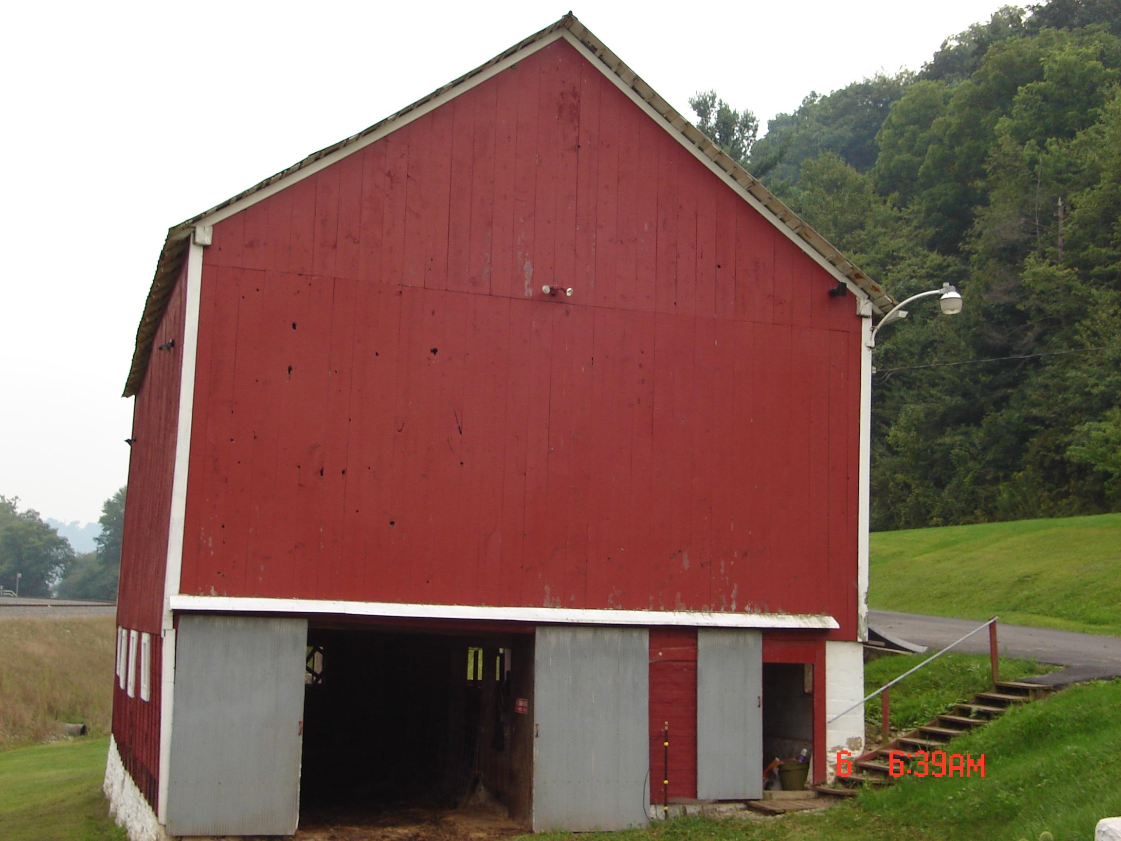

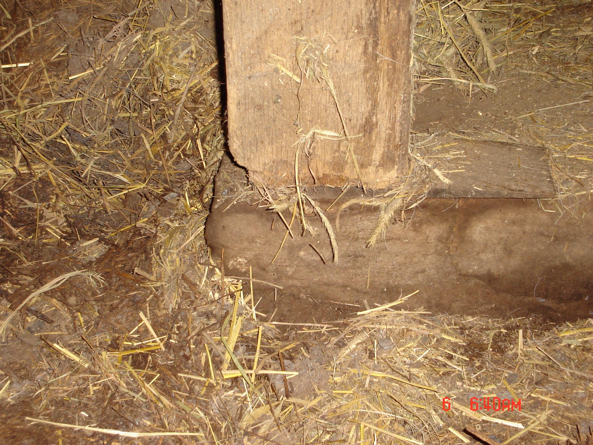

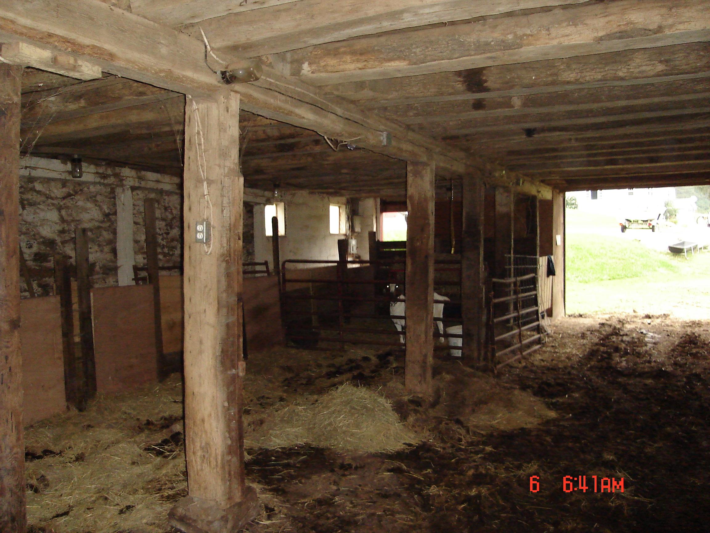

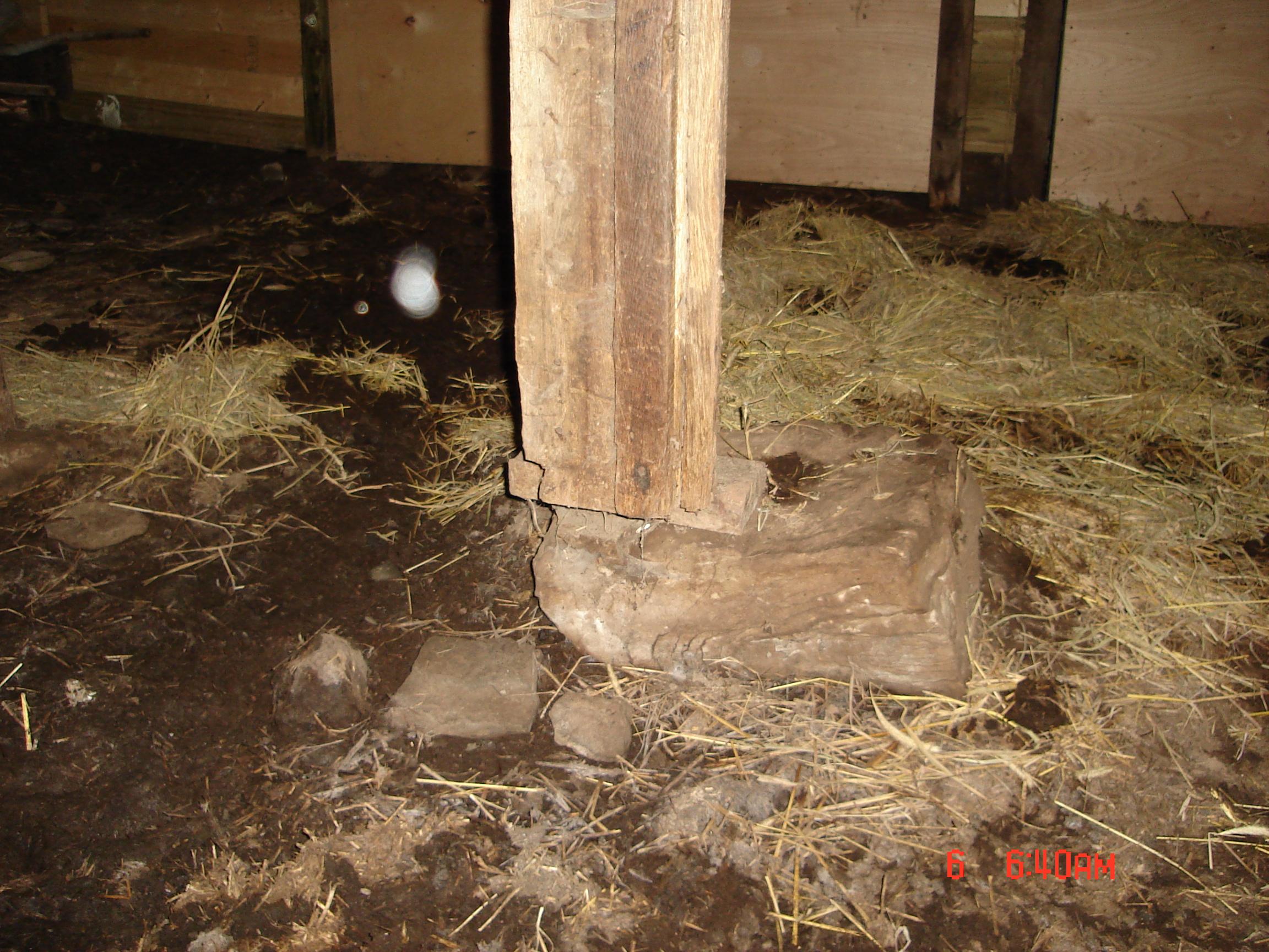

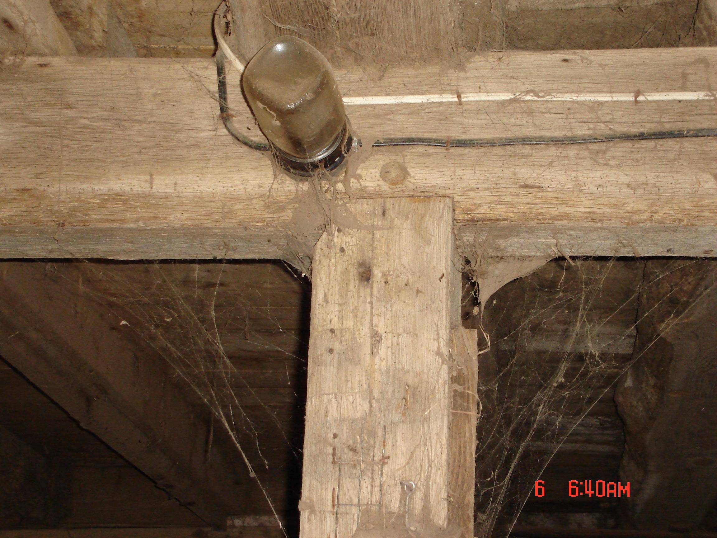

I need to do something with the support beams for my old barn. Pic 1 is of the ouside of the barn so you can get an image of the style of this barn. Pic 2 & 3 show the base of the posts and how they are sitting on large rocks. Pic 4 shows how the posts connect to the main beam. And pic 5 gives a shot lengthwise across the whole span. These posts are the center posts for the barn. As you can see some of the posts are not sitting very well on the foundation rock. I am looking for ideas as to how to remedy this. Do I just dig down and pour concrete up to the posts? The posts themselves are around 8 x 8 or 10 x 10 and are in good condition. What do you guys think is the way to go here? There is no sag or anything but I want to get the posts on good footings before something bad happens. I have never done anything like this so I am open for any suggestions.
Thanks

Allot is gonna depend on code for you location.
You will need to do the posts one at a time. You will need a very strong bottle jack. I use a 20 ton for residential homes, but you might want more for this. Put the jack on a solid footing and jack up the beam that the post is supporting.
Support the beam with another beam as strong or stronger than the one you are going to work on.
Do this on both sides of the post.
Remove the post.
Dig out the rock footing. Then dig out a hole large enough to support your load and meet code in your area. This is information you will have to come up with on your own for your area. For here, I'd want two feet by two feet minimum. I'd also want to bring it above grade 12 inches to support the post in a dry environment. Use some rebar in you form and attach straps to the rebar so you can tie into your posts.
Cut the post to fit the new footing and re-install.
