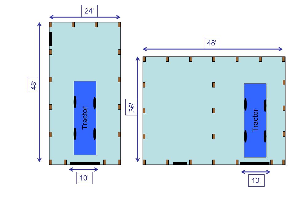

Thanks for the advice. To give you a little more information, I have pletty of flat land to build on but the pole building will be about 500 feet from the house so I can not run wter to it. I do plan on putting in electricity in the future and in general, I wanted to build it in phases: 1st get the building up so I can part my tractor, riding mower, and yard tools out of the rain; secondly add a concrete floor; and during the 3rd phase possibly put in a small workshop.
The weather here is mild as I'm in central Va and we got about 2 inches of snow this year but about 10 years ago we got about a foot each week for 4 weeks so I need to build for the worst.
I will probably put a wood burning stove in it and the tractor is about 8 feet wide and about 26 feet long with the FEL and the wood chipper attached.
here are a few rough drafts of what I'm thinking

Your 48 x 36 is the more practical plan for what you said you had in mind for the long term. The other plan would have you moving the tractor in and out to get to the back of the building. The 36 foot width will require you to go with engineered trusses, like Eddie pointed out, or interior supports. Not good if you are moving around a tractor with attachments and FEL inside the building.
Site prep is critical. Be sure you have good drainage all around. You will have over 1700 sq feet of roof dropping sheets of water around your building every time it rains or the snow melts. Without good drainage, the water will end up in your building.
Make your door 12 feet wide, you won't regret it. If you have the space, you may want to consider a drive-thru, put a second 12 foot door on the other side.
Don't forget you door height. You have to clear your ROPs as a minimum. The higher the door the higher your exterior walls.

One thing nice about a free span wider barn is that you can store attachments along the inside edges and have room to back up to them. That is, maneuver the tractor parallel with the overhead door. With a narrow barn, its like a large garage that you can only go straight in and straight out. If its narrow, once you get enough stuff, you'll spend more time dancing with it. Mine is 36 ft wide and seems to be more than enough width to maneuver a 43 hp kubota sideways.
Eddie's point about minimizing width to keep roof/truss expense down probably makes sense to a point, but a square will maximize area for a given length of wall(except for a circle). I'd have someone like Morton price the shell in several different shapes. BTW, I was going to add some leanto storage on the outside of mine and Morton said it was cheaper to just make the barn bigger!

I like the 36x48 plan myself. Like mentioned above you end up moving stuff out to get to the attachment in the back of the barn/workshop. We have a 30x60 and seems like you have to move everything around to get to the back (and we have doors on both ends of the 30's). I also like the bigger size because you can add lean-to's to the side or end if/when you outgrow the current building.

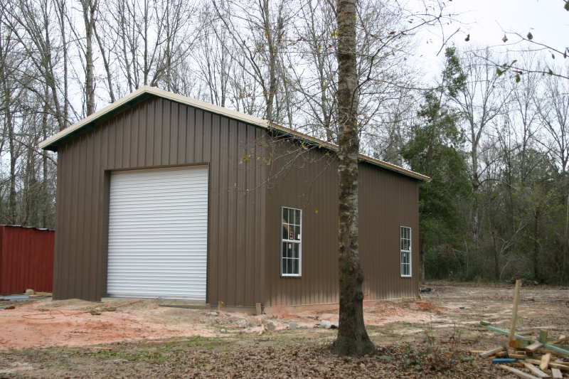

My neighbor and I are in the process of putting up two Heritage Steel Buildings. His is a 30x40 and mine is a 30x60. The 30x40 is going to run him about $14k for the kit. This includes one man door, one 8x10 overhead door, a 3/12 pitch on the roof, and eve extensions all the way around. The increase pitch and the eves add about $3k. They're both in NY, so the snow load will be substantially more for us than for you, a factor which would probably decrease your price even further. We're putting them on piers instead of a slab. A slab may come in the future, but not now. I'm doing the foundation work myself, so I can't really give you an accurate idea of how much that would cost, maybe $4-5K is I had to guess. Installation for the 30x40 by a contractor will run a little less than $6/sq ft, but once again, the eves and increased pitch add to that. What I really like about the steeel buildings is the fact that there is no wood to rot in the ground.....ever, and there are not trusses. You've got usable space right up to the ridge. I spoke to a ton of manufacturers before I decided on Heritage. They had the best price and the best service....so far. I also looked at Morton for a pole building, but then decided against wood. As far as steel goes, if you decide to go with it, don't go with General Steel.
