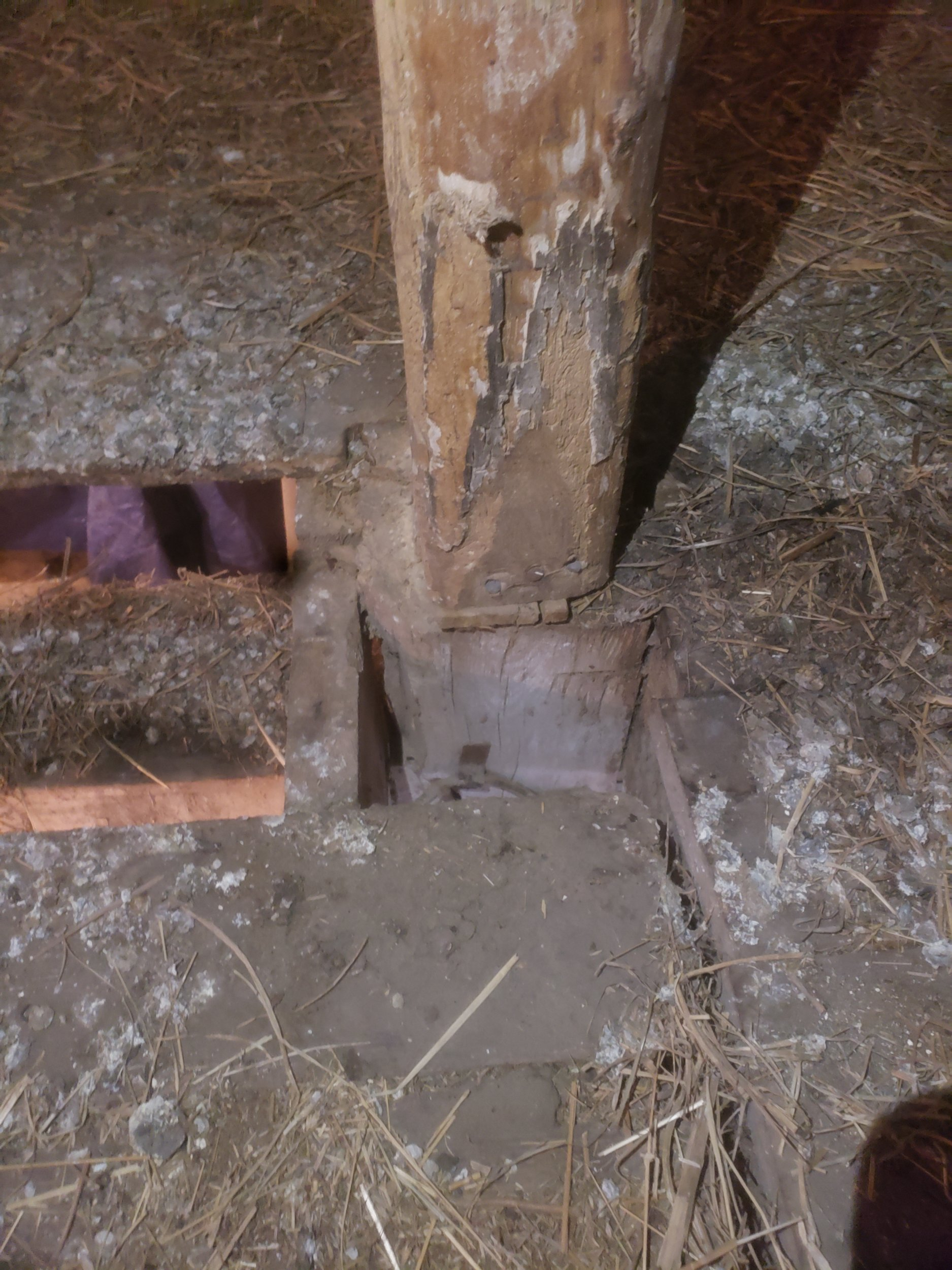

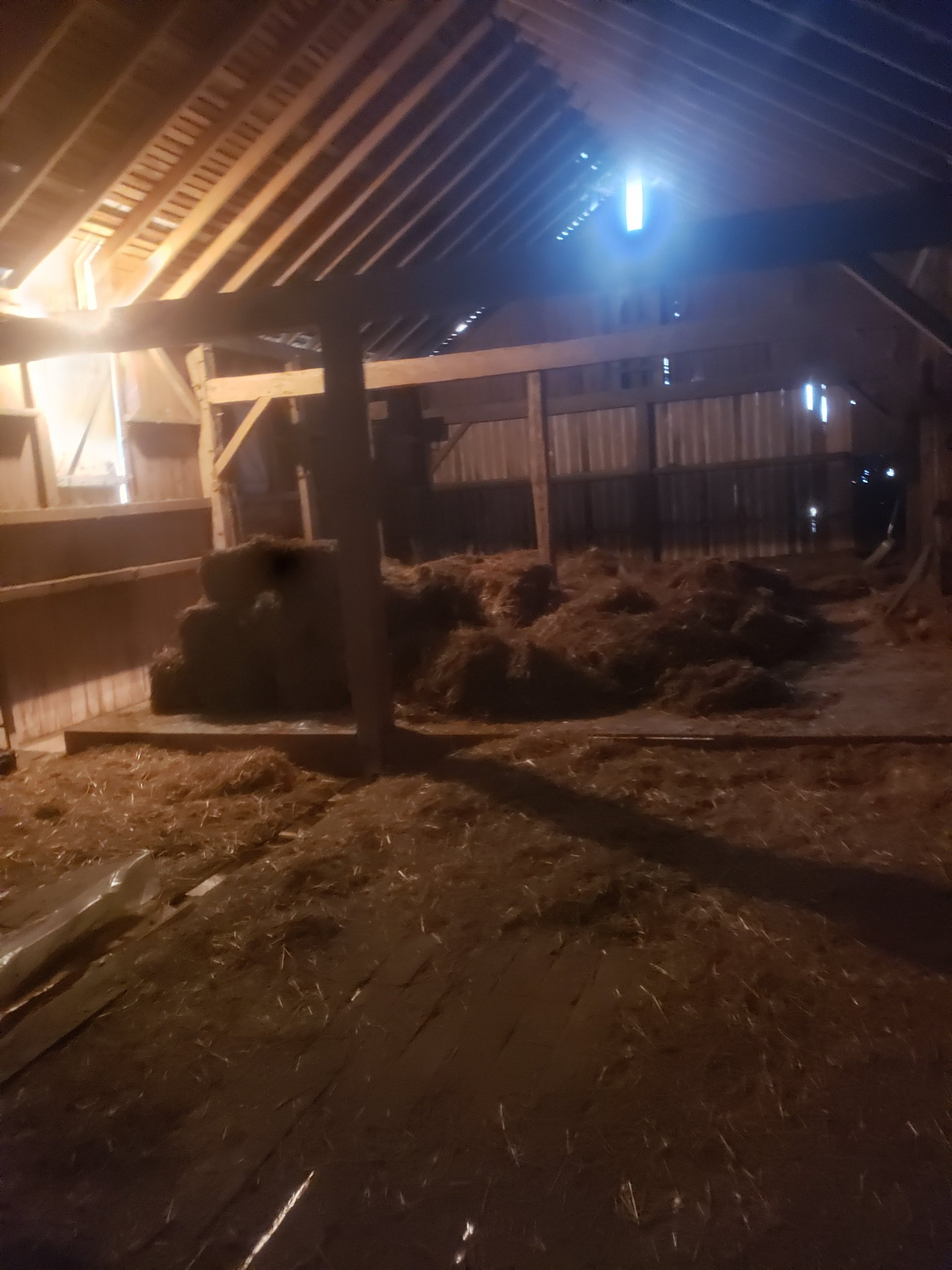

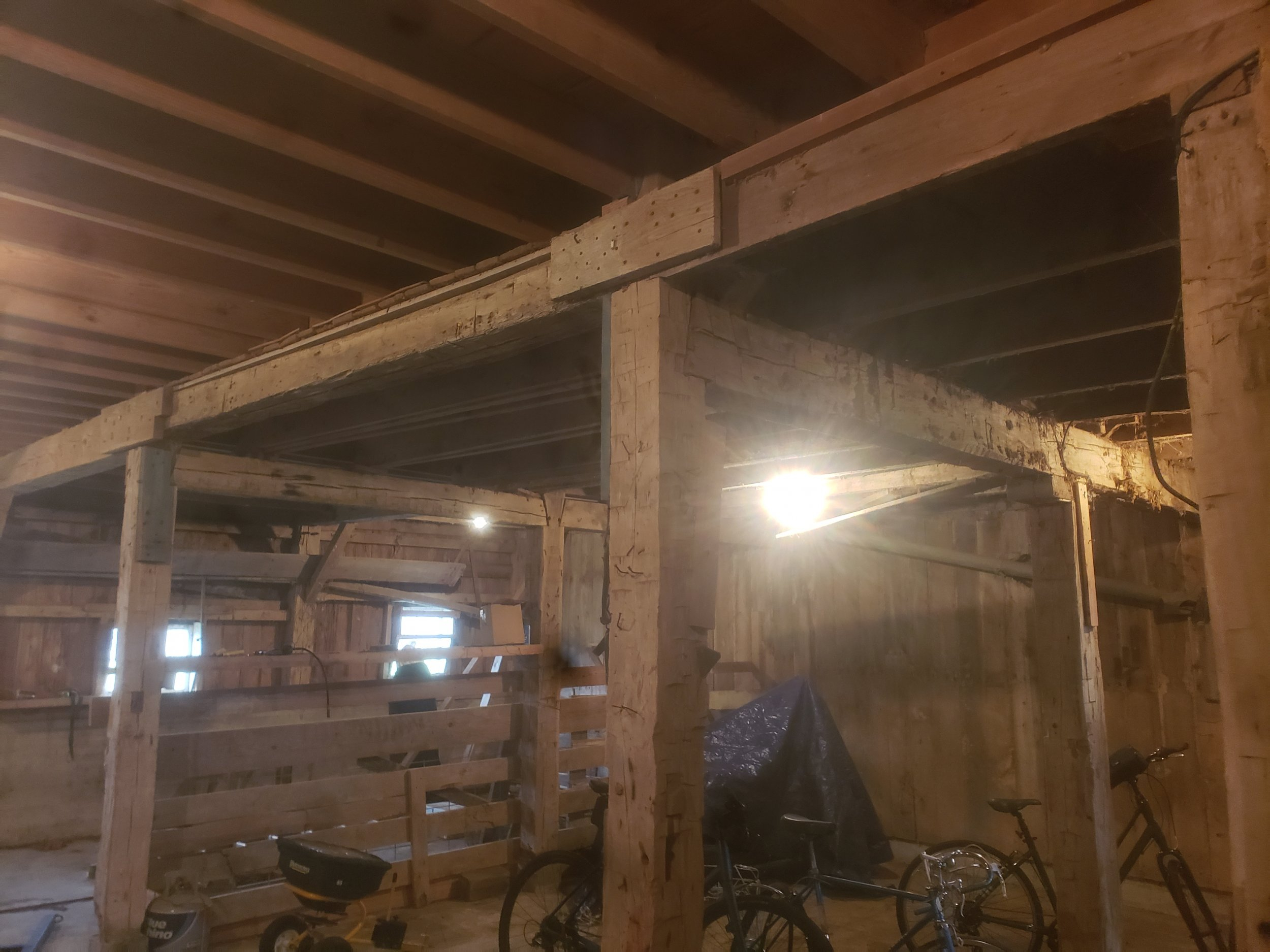

Hi folks. I wanted to post a few pictures. I am considering removing my barn loft, mainly the center section. I plan to leave the support posts in place. My question is- does the flooring of the barn loft, and the floor joists of the loft floor add any structural support to the barn? I.e. keep the barn from spreading or pushing in? Or is all of that done by the posts? I plan to consult an engineer if moving forward, but curious of your 2 cents.

I don't think the loft floor is structural. Although as these old barns age and settle you never know what is "contributing."

Seriously though...other than shear strength against high winds I cant think of any..but I am not an engineer.

Not to pick on the question, nor am I an engineer, but I can think of a number of ways that the floor adds strength to the barn. Resistance to wind thrust, shear, added bracing on those vertical beams to keep them from shifting...

I know of 2 old barns that the loft floor WAS a big part of keeping the walls from separating. One of them was my neighbor's barn growing up and it was a big dairy barn. We ended up a bunch of cables holding the walls together to the floor. The barn is long gone because of a housing development.
The other barn is my neighbor's now. It is still a big barn but is smaller than the first. He said the ends are held to the beams by pounding wood dowels into drilled holes. Everything is slowly letting go so he only fills the loft 1/4 full.
