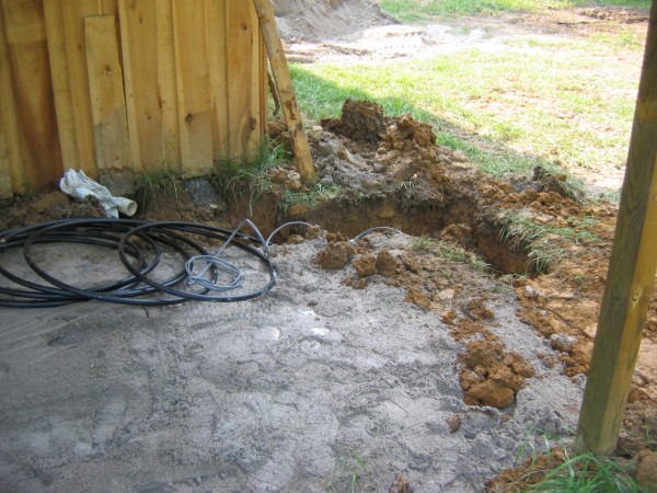

I had a floor drain and a cleanup sink drain put in my new barn floor. You can see the floor drain pipe in the attached picture. I will run solid pipe from the corner of the barn to edge of field (about 80'), which drops off quickly. How deep should I place the pipe and what is a reasonable slope? And since I am using my new BH to dig the trench, is there a trick to getting the slope correct while I am digging?
BTW, you can see the water line and electric line I placed in a trench last weekend. It was my first time using the BH for a trench. The trench was about 40' long and I used my 12" bucket. Thanks to the advice here, I was able to dig a trench that was amazingly level /forums/images/graemlins/grin.gif.

With the drain line, I would have it drop at least 1" in 12', if mine. I also would place it in as straight a line as possible, or at least without any 45 or 90° elbows. That way I could run a tape through if needing cleaning.
For depth, I wouldn't be less that 12" just to avoid tearing into it with surface tilling, etc.
Sounds like you have the 'tricks' down to get a good ditch with the bh. /forums/images/graemlins/wink.gif A 12' 2x4 and a level will get a slope easily. Could even put a block on one end of the 2x4 to add the 1".

Rule of thumb would be 1/4" of slope per foot. 80' run...1/4" per foot...you would be 20" deeper at the other end (drop off in field). You want it to be pretty consistant; and you need to put something like pea gravel or crush and run down to keep your pipe from sagging or setteling out too much when you back fill and things settle out on top too.

Before you start to dig, take your 2x4 and level and check the natural slope of the ground. If you have at least the 1/4" per foot slope just dig at a consistant depth. No transit needed. I have also tested things like this with some string and a string level. The trick to that is getting the string tight enough so it does not sag.

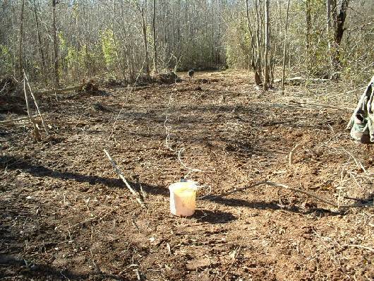

I don't have a level or transit, but the bucket and tube method (I use 100' of 1/4" tube and a two gallon bucket) is an easy way for one person to measure levels over a two hundred foot distance, accurate to as close as you can read a tape measure. Costs next to nothing. In the picture I've got a piece of string holding the tube to the bucket handle. I plan to upgrade to a clothes pin.
The water moves through the tube faster than you'd think; a second or two to settle out from several feet change in level.
Wm
