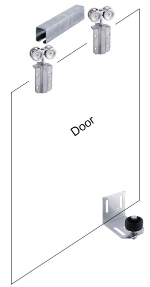

Here's a drawing of the parts you'll need. Note that it doesn't have a track at the bottom, just a roller to keep the door in towards the wall.

You need to plan ahead if you are going to use the rolling doors. My son had to use one of those because his shop had an odd size door 9'. So we installed a rolling door. Got the hardware from Stanley. Welded up the frame from 1 x 2 inch tubing. With rib metal siding. The bottom needs to fit below the floor level. That way you get a bit of a seal.
His isn't air tight as a roll up, but is weather tight.
