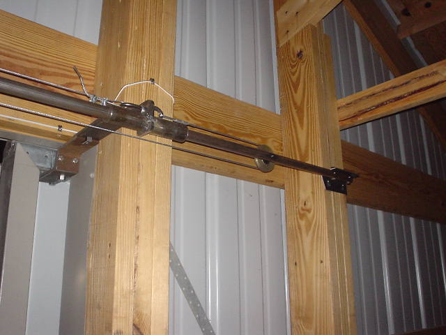

This is in followup to the barn door opener thread about using an overhead garage door opener to open a double sliding polebarn door. Originally, I vowed to use a separate opener for each door to avoid getting sucked in to a complicated project of making one opener do both doors. Well, I did get sucked into the one opener design but it worked out well so it wasn't so bad afterall.
Basically you buy an opener and throw away their track and trolley. Then you make your own track and trolleys, extend their chain with bicycle chain, and get some extra 3/32 cable. The setup is described in the other thread where the chain/cable makes a loop near the top of the door. One door is attached to the top of the loop and the other door to the loop's bottom so that the doors move in opposite directions.
This first of three pictures shows the left door fully open and the power unit. Since the chain sags, you have to look hard to see the top of the loop. With this setup, I lose about 6 inches of opening/door on an 18 foot opening. Also in this picture you can see that the connection between the track shaft and door is two pieces that can be disconnected in case of power failure. The two piece design also accomodates vertical and in/out misalignment of the tolley track and door track.

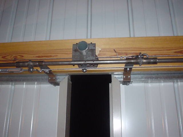

This last picture is of the other door (right) fully open. My neighbor gave me that idler pulley off an old garage door opener, made from solid steel and a ball bearing. The Sears pulley was solid plastic. I'm happy with the way it works. It opens twice as fast a an overhead door since there is two doors moving at the overhead door speed. And it seems kind of dramatic as it opens, like stage curtains!

oops. Wrong picture. Try this.

Are you running limit switches or do you just watch for it to open and close all the way and then let off the button?

The Sears power unit has built in limit switches for both up and down. One screwdriver turn equals three inches of door travel. Its very convenient.
John
