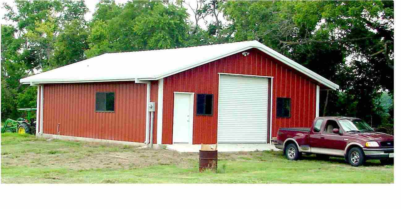

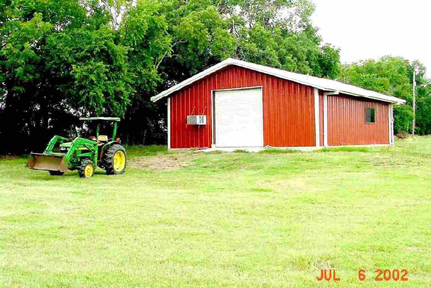

I have a 30'x40' with 10'x10' doors centered front and back. Makes easy access to all areas. I don't have to move something out to get to something else. I have probably about a two foot drop at the back. Since you state there is a tree in the way even though you haven't built it yet, I assume you are limited on location of the barn. Is it not possible to shift 10' or so to one side to avoid the tree?
Attached is a rear view.
