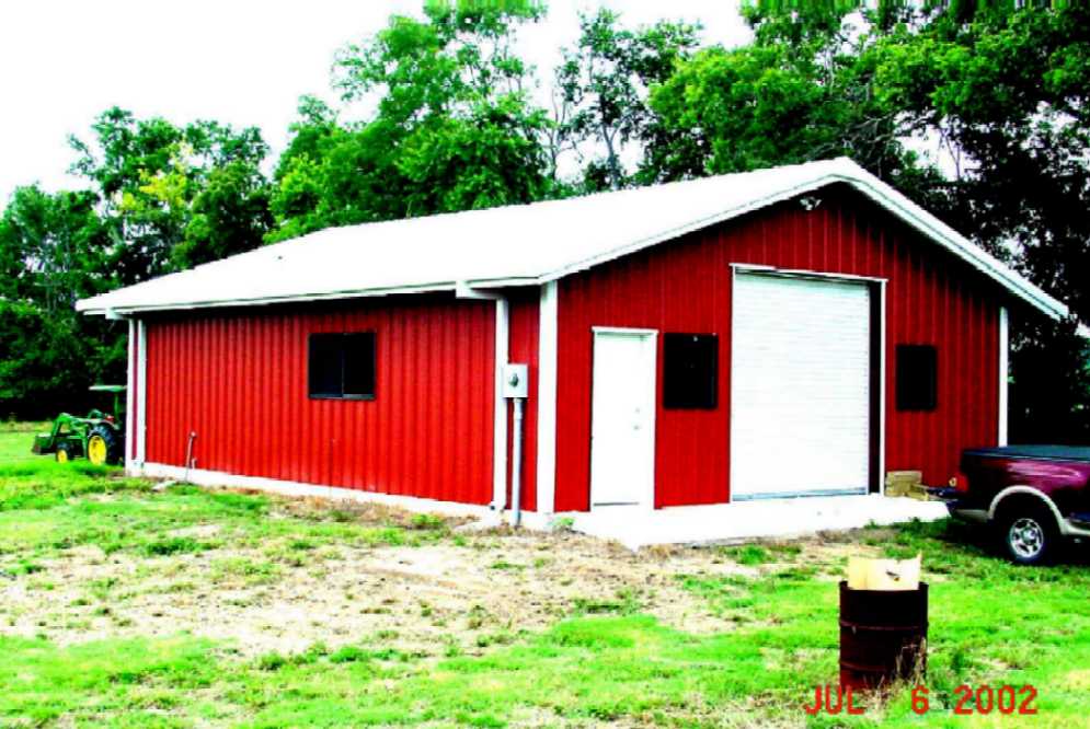

Shifting and cracking foundations is a well known problem in this area. I put up a 30'x40' metal building 4 yrs ago. I hired a concrete contractor with a good reputation for my slab. It is beam and slab rather than pier and slab. By beam, I mean they dug a trench 1'+ wide and 2'+ deep around the perimeter of the slab site. Then they dug a trench down the middle front to back and another at the middle side to side. The trenches are filled with concrete as the slab is poured to form beams. In the beams (trenches) they put 8 rows of 1/2' rebars. For the slab they crisscross 3/8" rebar every foot or so. They also poured a 20'x3' apron in front and a 10'x3' apron in the rear. All total, they poured 39 yards of concrete. After they set the forms and before they poured, I made them remeasure to ensure they were correct and square (and they had to readjust a little). Then I fabbed some anchor bolt holders from some 1" boards cut to size to hold my 20 anchor bolts and firmly attached them to their forms. Then I remeasured all that. That way I knew everything was going to be correctly in place. The result came out great. (Well, I did have to torch about a half inch out of one hole in one column.) After 4 years, the slab still looks great. Some very minor cracks, but nothing that even remotely appears that it will become a problem. Attached is an outside view.
Do your plans call for a shelf around the perimeter of the slab to prevent water from getting under the steel siding?

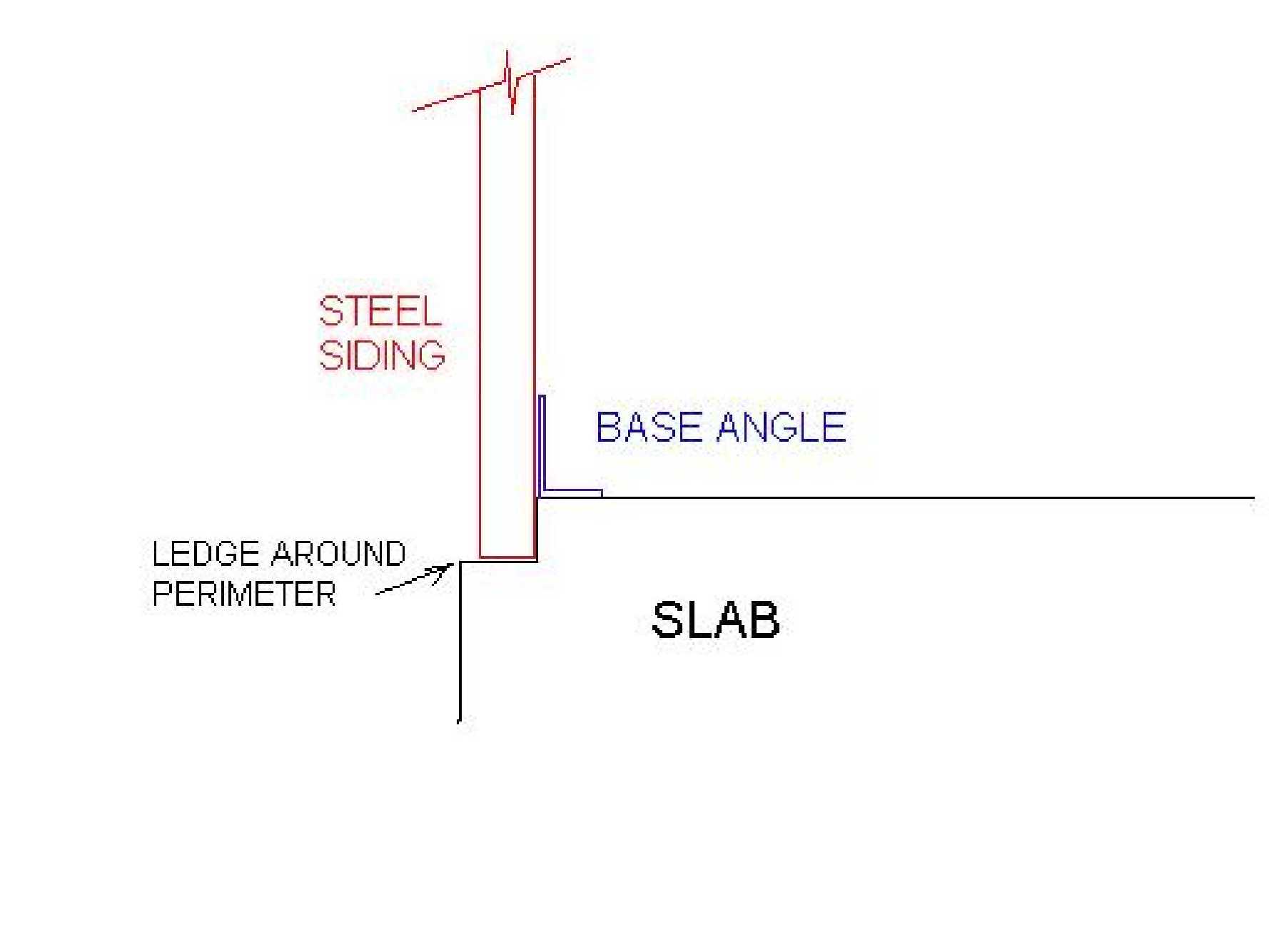

RichT - Here is a sketch of the shelf or ledge around the perimeter of mine. This method ensures that (short of a flood) water can't get under the sides. When they set the forms, they nailed a 2"x2" to the top of their forms all the way around the perimeter.

BB, thx for the pic...NOW I understand what you were saying before. Duh. Excellent idea...I'll consider it.
