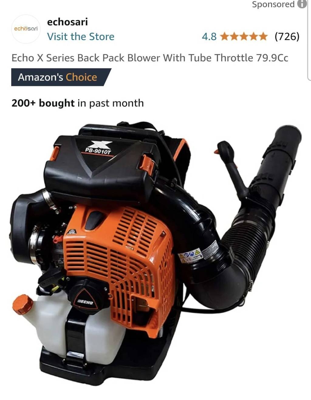

One of the best things I ever bought was this Echo backpack blower that can blow leaves into the next county. Hit the throttle and it twists my back!

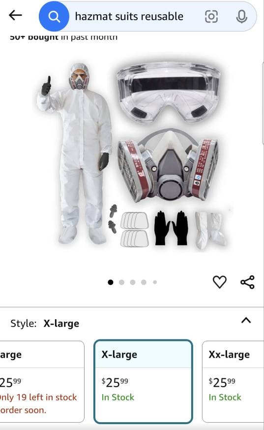

I see Amazon sells hazmat suits for $26!
Wife thinks it's a crazy idea...but with doors open I bet it would blow clean barn back like new in an hour.
Thoughts?

I predict hay dust will be choking unless you have a good respirator and eye protection. Hazmat suits/respirators are also hot to wear.

I have done this. Don't use that crappy respirator. I have a full face 3m respirator with filters that i use. I don't bother with the hazmat suit, just whatever I'm wearing. Blow everything out and it works great. Takes about an hour for the dust to settle.

I just fire up the Echo hand held we have on a very windy day. All I use is cheap a 3M 6000 mask off Amazon with a set of p 100 cartridges . I use the same rig for welding inside. Fire it up and away it all goes out the door back where it came from.
If you happen to wreck that one for some reason, try a 7500 series on the next round.
The silicon seals on the 7500 are a LOT more comfortable IMHO and the price increase is relatively nominal. I went through a couple different masks for sanding woodturning projects (dust collection is .. not impossible.. but extremely difficult) and found the 7500 series to be the most comfortable of the half face masks I tried (there are some I haven't tried so I'm not claiming it's THE most comfortable.. just that it's nicer than the 6000 series).
I'd agree that the full body suit is probably overkill, but I'd prefer to have eye goggles that are of the actually sealing around the eyes kind.. I've had enough red eye in my life haha.

Big blower for sure - it's just over 30 lbs and I thought my Stihl BR400 was heavy enough at 19.6 lbs.
