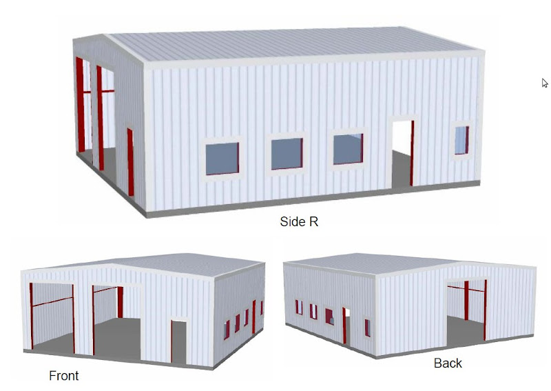

... what do you think?
1) I based my price on my investigation of getting quotes for the single items by contracting all out and pursue permits by myself. Metal building frame with metal sheeting, no fancy extras (~16,000), 4" slab reinforced and geo-technical documents (~11,000), three roll up doors (10x12), two normal doors and 4 windows & misc. items (~5,000), permits & time (~2,000), equipment rental (~500). So I figured if I have to do all this by myself I have to pay $34,500 plus headache, beer and food for numerous helper.
2) I have a pole barn quote, wood framing but metal sheets, 5" slab , doors and windows for $32,000. It is yet still questionable if the City of Houston allows pole barn within their city limits. I was told this is a problem.
3) One quote for a wood framed (on top of the 4" slab) including all doors & windows etc with downspouts and permitting (turnkey) for $42,800. I was told that the same building with metal frame would be 8% more - so $46,200. Builder makes a very good impression so far. I will visit a similar barn that he build recently that is close to my location.
Other quotes are similar.
I seriously consider the option 3, wood framing - all inclusive for $40,000 (I think I can get this down a bit).
Is this a good price for a turnkey project? What should I look for when I visit the other barn?
All comments are much appreciated!

I contracted a guy today:
40x44x16 metal building
concrete slab 5" designed after an engineering drawing with 8 pillars (that was an extra $850)
4" isolation roof and walls
(3) 12x14 roll up doors
(3) 3x5 windows, 1 2x2 window
(2) man doors
(4) skylights
I looked at some of his previous work and I have a bunch of good references.
$29,000 turnkey
We need to bring in some dirt - that will be extra.
