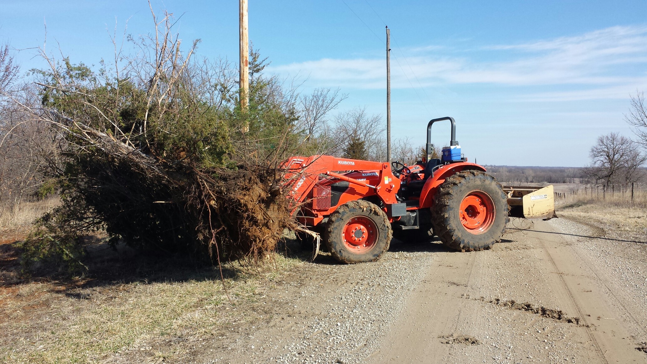

I've looked for over two hours and can not find anyhere that tells me how to calculate how much ballast - either in my tires, on the 3-point or both - I need for my tractor. I have no problem with creating ballast - I just want to know how to calculate how much I need. Thanks

On April 1 you posted you have 68 gallons of Rimguard in each rear tire. 746 Lb. plus a 675 Lb rear blade. How much more do you need? Is the rear still too light when using the loader?

That is exactly correct(1500 lb of rim guard & a 575 lb rear blade). In a week or so I will be having a grapple installed. I really do not want to find out if what I have now is sufficient or not by trial & error. I will, with the grapple, be able to put a significantly heavier load on the front than with the bucket. And no, the tractor has never been light in the rear using only the bucket.

Well then, I guess to be safe you'll need to put about 3K on the 3 pt. Not trying to be smart but if you think you are going to increase what you lift with the loader then max out the 3 pt. ballast. In all seriousness probably 2K on the 3 pt. would suffice.

Somewhere, I have two pages of formulas & intense calculations that will allow you to determine how much can be safely lifted up front(bucket or grapple) when you have X amount of weight on the 3-point and in the tires or both. I haven't found them yet and I was kinda hoping somebody had some easy way to figure this out. Believe me, the calculations I had were intense to the extreme. I know by running these calcs, about two years ago. that my current ballast - rim guard and rear blade - is sufficient for anything I would be lifting with the bucket. Unless it was something like wet concrete and I'll never be there. However, a lot of the ponderosa pines I have would easily max out the FEL with a grapple on it.
My 3-point can handle up to 4200 lb. If there is no quicky method of doing this I will have to do some serious digging and then run those nasty calculations. If I find I will need added weight I could modify the rear blade to hang something like suitcase weights on it.
Thanks for your input guys. Oosik

I'm sure someone smarter than myself can give you a better idea of how to calculate that but take a look at Levers
and I think you'll see that it takes an enormous amount of weight on the 3 pt hitch since it's "lever" is only 2 or 3 feet behind the fulcrum to unload the front axle but anything helps counter act on the additional load that maybe picked up in the bucket.
