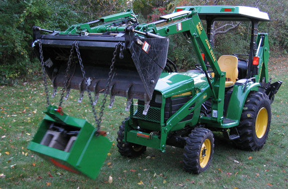

I use my ballast box when I want to work just with the FEL in tight spaces. It has the JD quick attach system and takes about a minute to backup to and hook on. I have loaded it with about 400 lbs of cement blocks and suitcase weights from my tractor front bumper. That's not enough and I'm planning to fill it with sand when I have a minute. I've attached a picture of moving it the other day when I had the backhoe on. Those chain hooks on the bucket come in handy!

That's a serious looking 4-n-1 bucket, Bebster. It's not John Deere is it?
   / Ballasting Box #7
Yes, my dealer said it was JD, but it may be just resold by JB and manufactured by someone else. It's 60" wide and works great for me, since I have lot of scrub-brush to pickup. I added a toothbar to it which you can see in the picture. That is super -- I can dig up small trees and bushes with it, and then grab them with the bucket jaws and away they go to the pile for burning.
