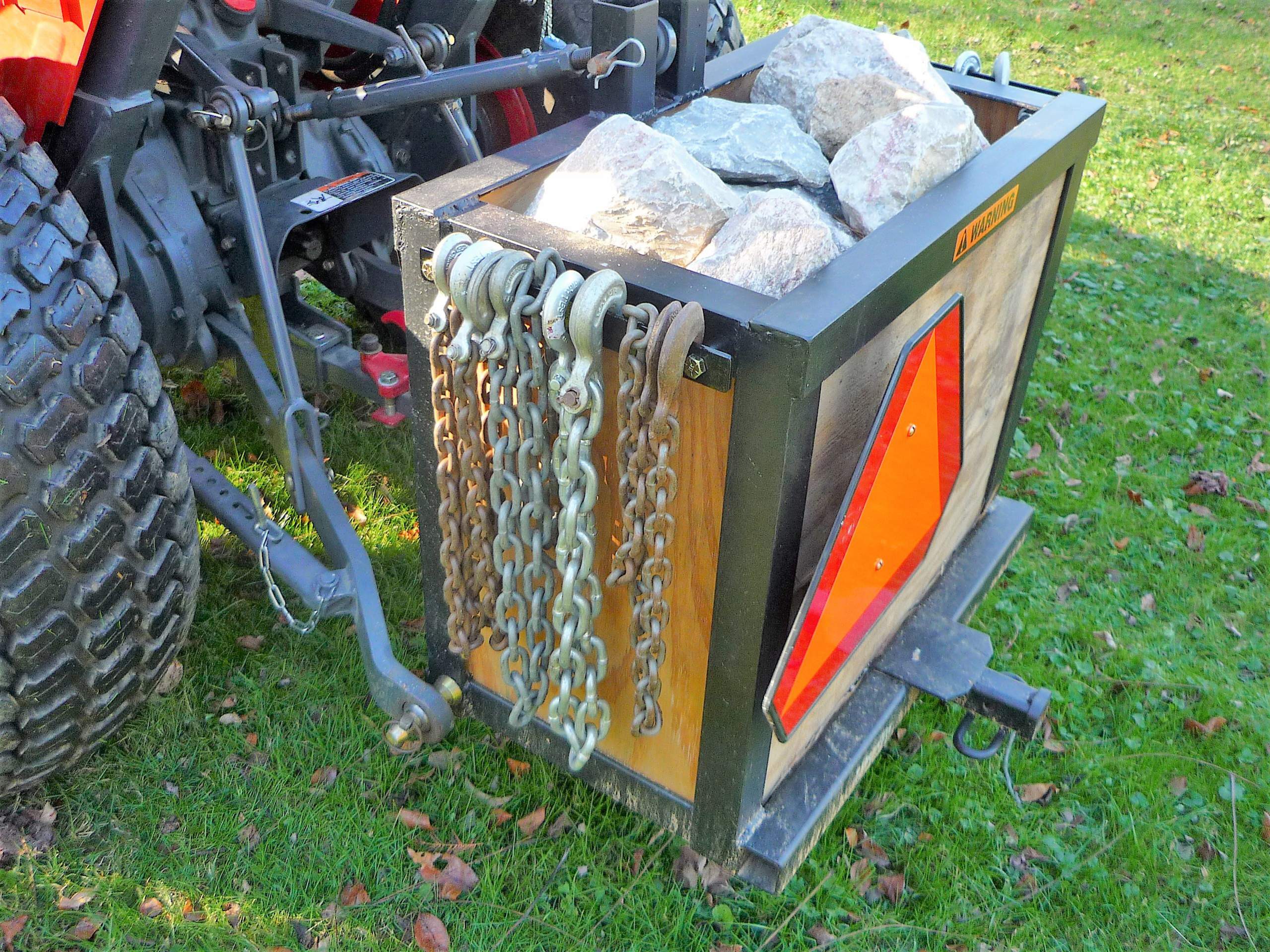

One solution would be a steel frame ballast box, filled with whatever. I had some heavy rip-rap rock, which adds about 400 lbs if I fill it up. Easy to empty or remove the whole box, if wanted. Made for a handy chain carrier, too.

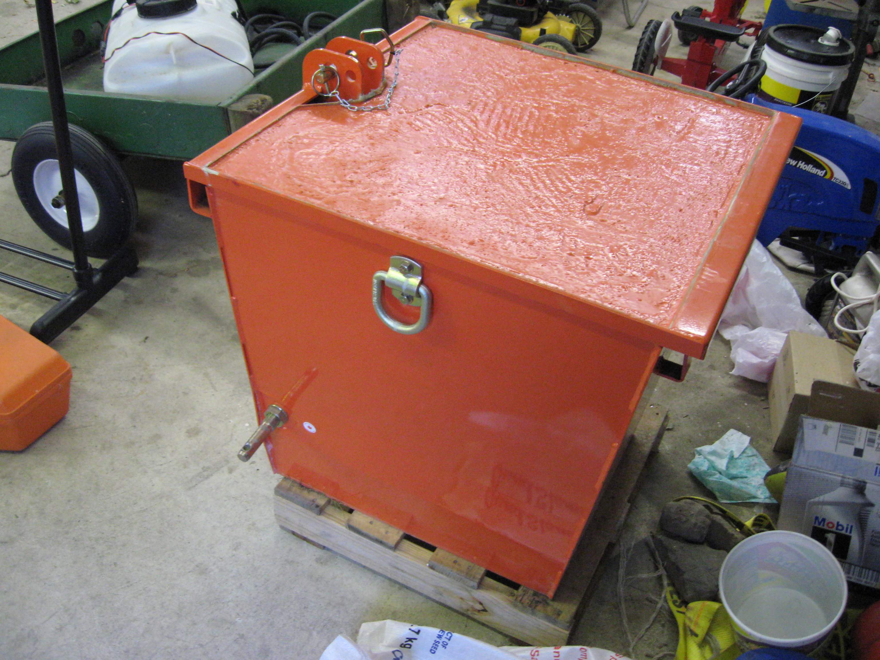

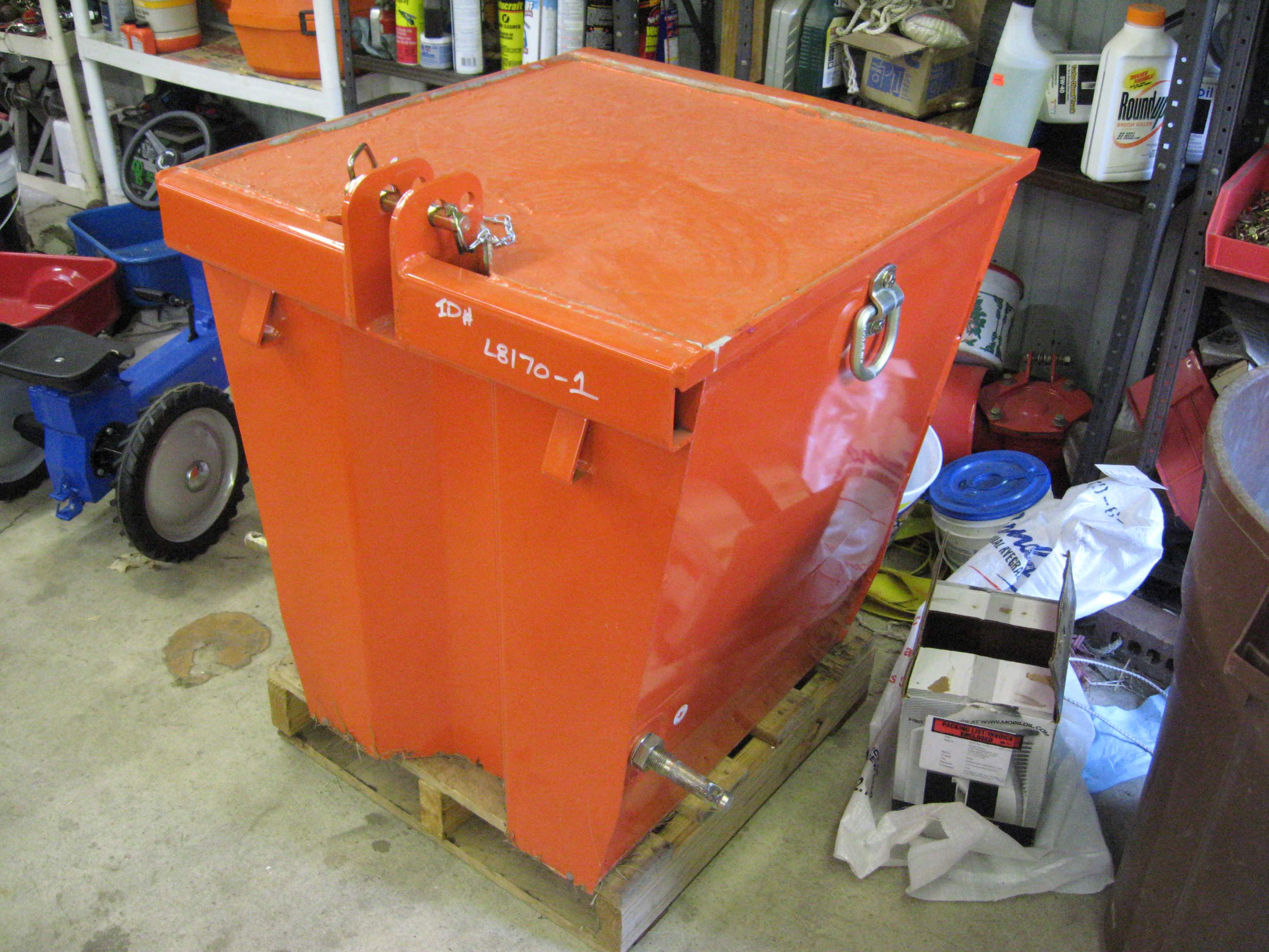

I like ballast box because it is compact and heavy. This one filled with cement weighs 1250#. Philip.

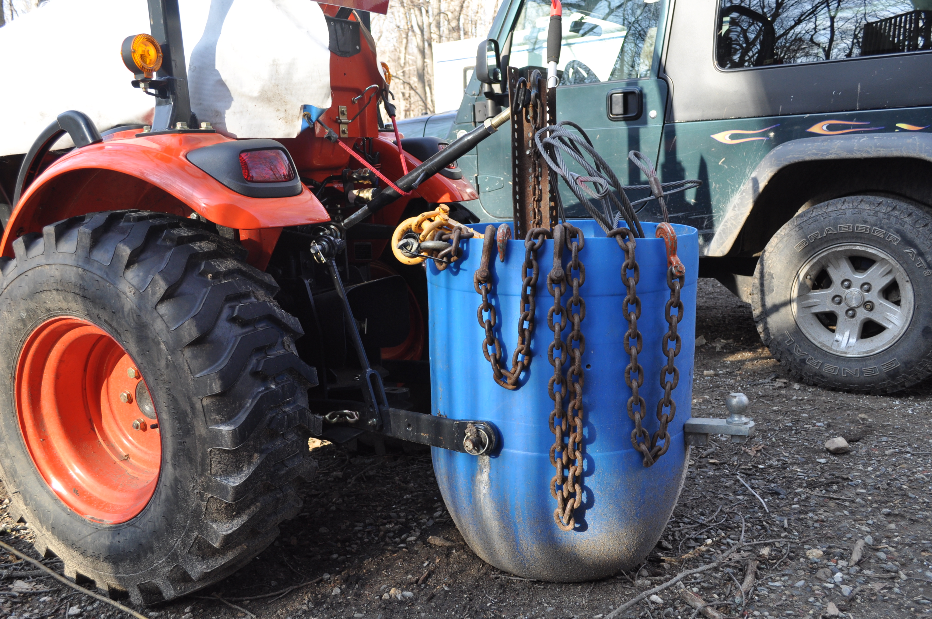

I made one out of a bucket (free). a piece of black pipe, rocks, 6 bags of concrete and some scrap angle iron. I embedded a 2" reciever i had lying around in the back so I could move my trailers around. It weighs 650 lbs.DSC_4180.JPG
It's not pretty but it works and there is room in top for tools, chains or more rocks. It works much better than my box blade which only weighs about 350 lbs.
