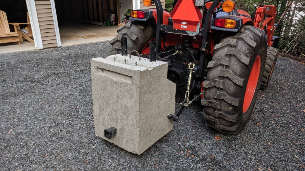

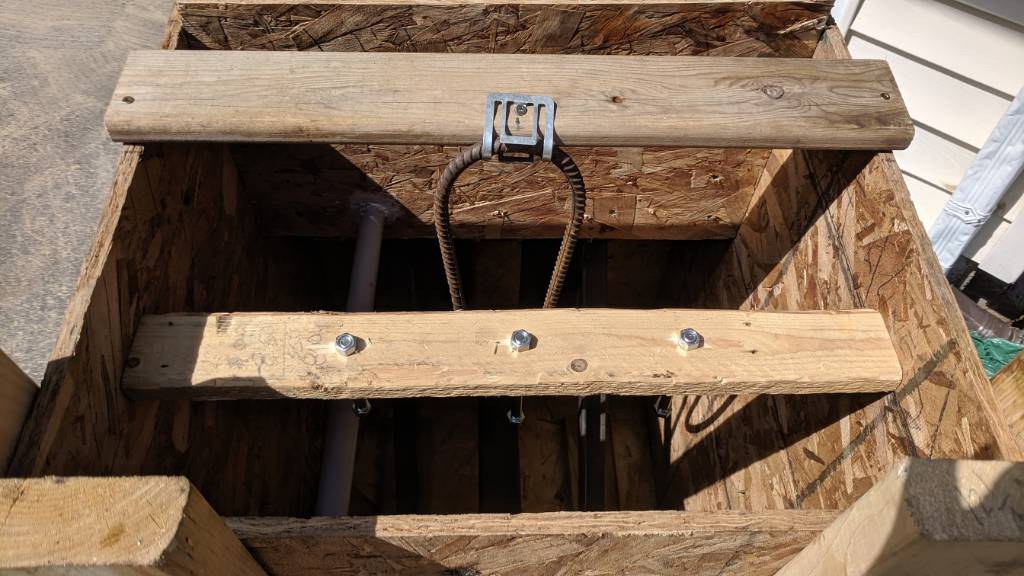

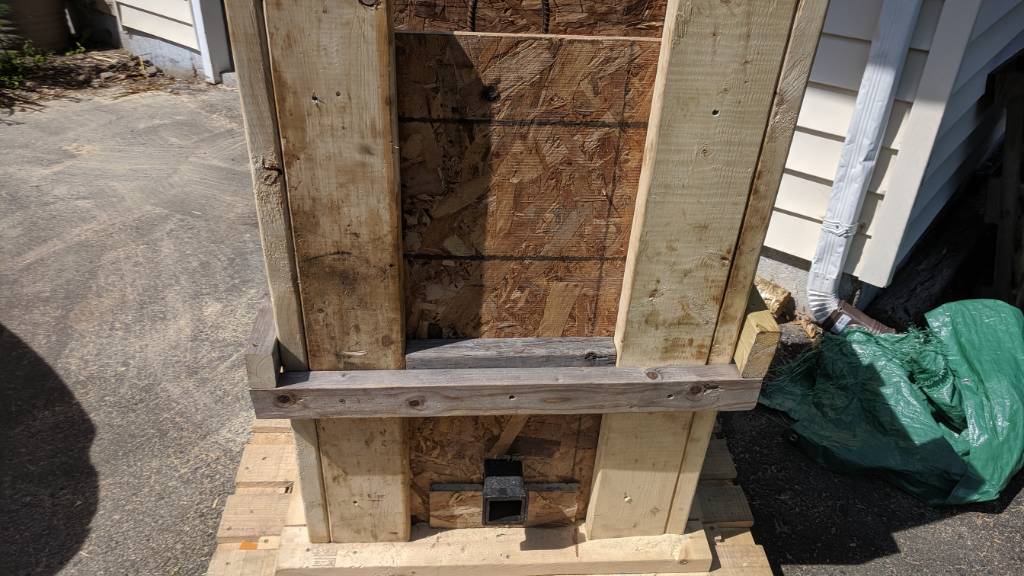

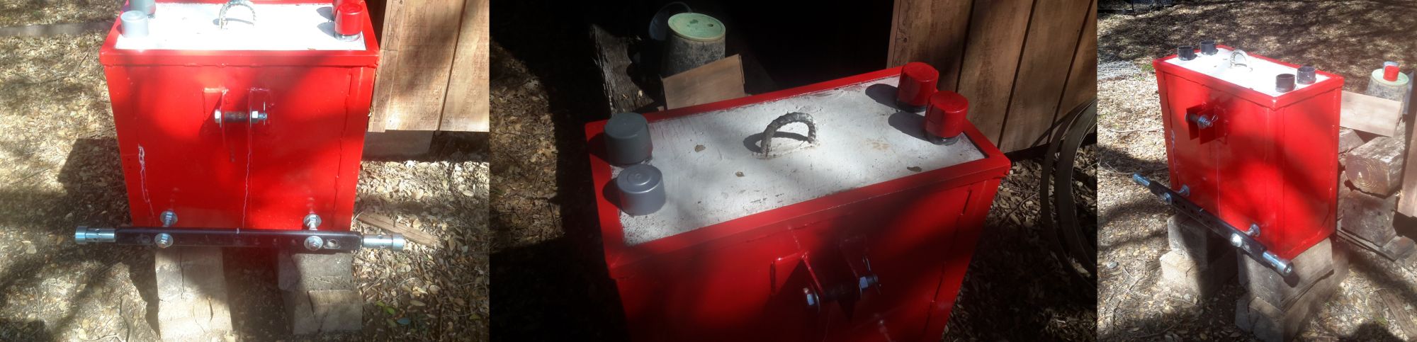

I just built one. I bolted a cat 1 drawbar to a 24" long 2" hitch receiver along with some angle iron for the top link and for structure. Then I built concrete forms around it screwing the forms to a pallet. I took the forms to a Ready-mix place and they filled it with leftover concrete for a donation to their staff coffee fund!
Mine is over 8 cubic feet x 150lbs per cu.ft. about 1300lbs total for a 50 HP tractor that is rated at 2600lbs of loader lift. It feels like plenty of weight for what I expect to be lifting - logs, rock, gravel.
It measures 22" wide (quick hitch compatible), 24" deep, and 30" tall in the back. The top link angle iron is 22" above the drawbar but so far I drilled toplink holes at 18" (cat1). The drawbar pins are 8" above the bottom of the concrete and in 5" from the back.
If you built forms 22"x22"x22" that would give you 6.1 cu.ft. or 900+ lbs of concrete. Make sure to angle or notch down near the toplink bracket so the toplink does not hit the concrete when you lift the ballast.
Have fun. IMG_20190717_164444.jpgIMG_20190720_153822.jpgIMG_20190720_153833.jpgIMG_20190729_175403.jpg

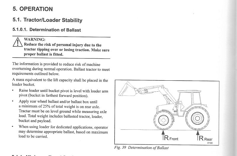

   / Ballast Box #7
Thanks guy. I have searched the multiple threads on ballast boxes. Just trying to get an idea on how big and heavy for the 32hp tractor.
From my tractors owners manual...
Typical manual writers speak... Who has said scales available to work with...
Dale
