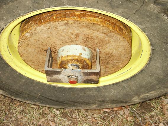

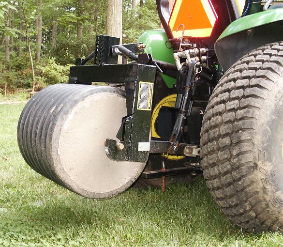

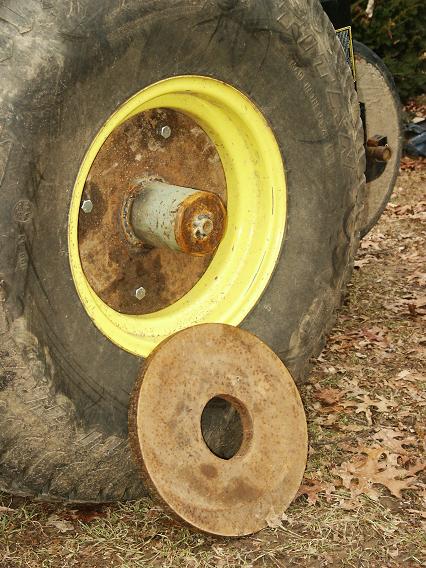

I have weights on the wheels but when doing serious lifting I also put on the 3pt ballast.
