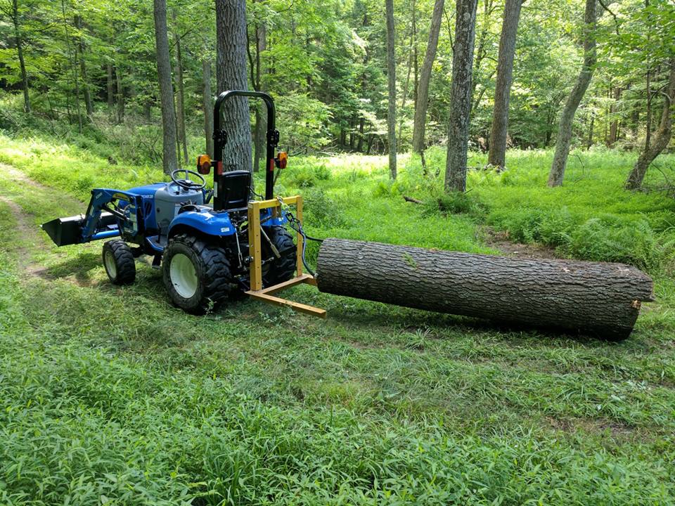

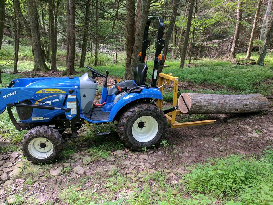

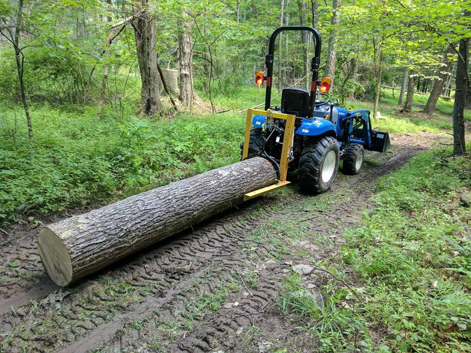

I use my carry-all in a similar way. I welded a hook on the upper part of the carry-all frame and use log tongs with a short piece of chain to adjust the height. These are some red oak logs I recently skidded, the biggest was 21" at the butt. That was about all that tractor wanted to handle. 3.jpg2.jpg1.jpg

Anything being drug below the level of the rear axle can flip you over backwards. Going uphill would only make the problem worse. The previous poster's use of the forks/carryall on the back would help prevent that. Whatever you do be careful and watch your front wheels continuously. If they start to come up clutch it or let off pedal. Nothing scarier than having a tractor wheelie with you trying to stop it.

I think its anything being drug ABOVE the level of the rear axle can flip you over backwards. That's why the drawbar (for pulling) is located under the rear axle.
As for those forks/carryall, he's got the load chained to the top of the them. Easier to pull over backwards. And the forks are on a 3pt hitch, which floats up, won't act like wheelie bars. Think about backing a brush hog on a 3pt up to a hill. The brush cutter comes right on up without touching the 3pt lift control. 3pt hitches use gravity for down pressure, not force.
Of course, he does have them all the way up in the photo, so it may help a bit, but his nose will be high in the air before the rear of those forks stops the backwards rotation.
