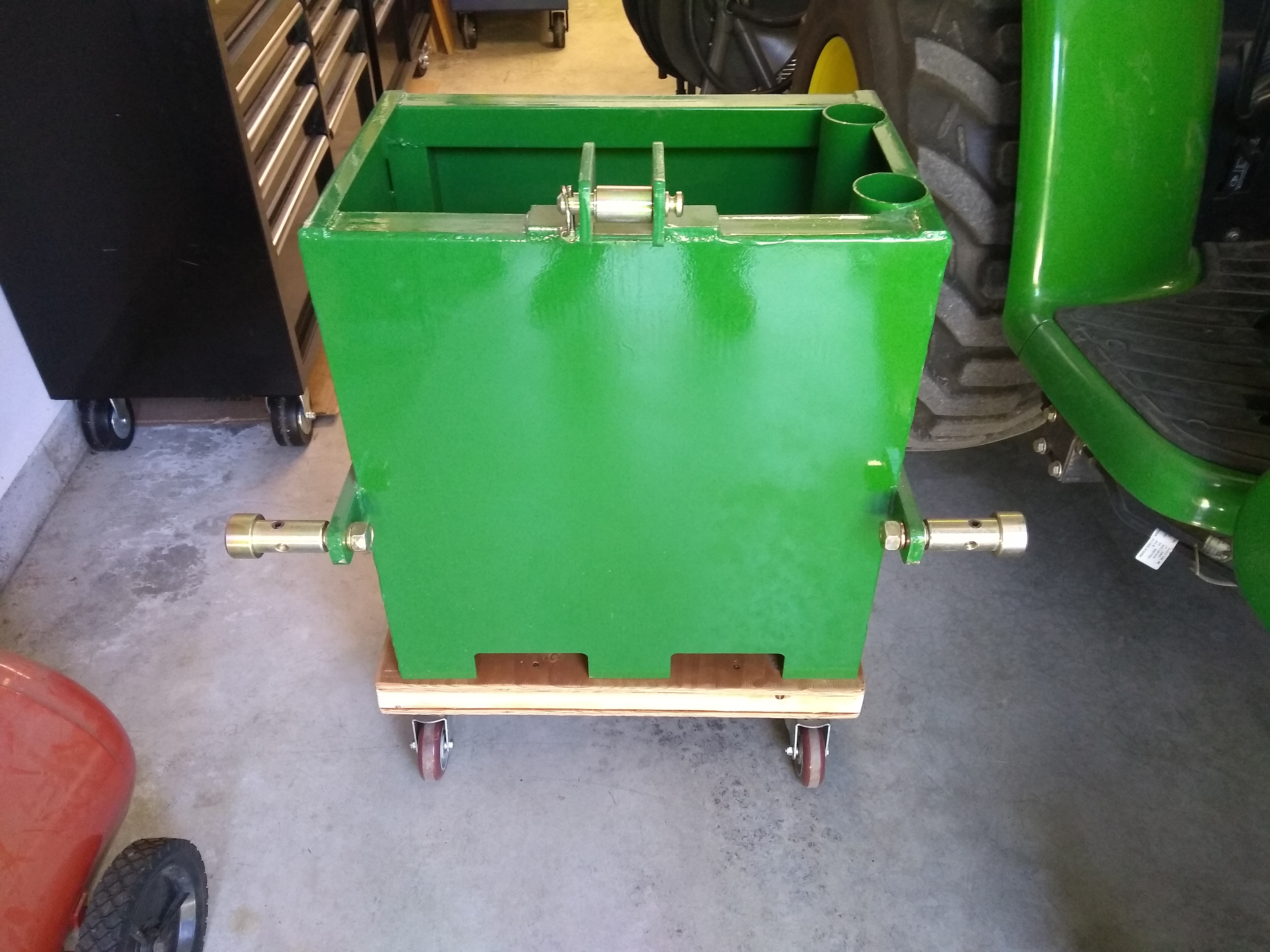

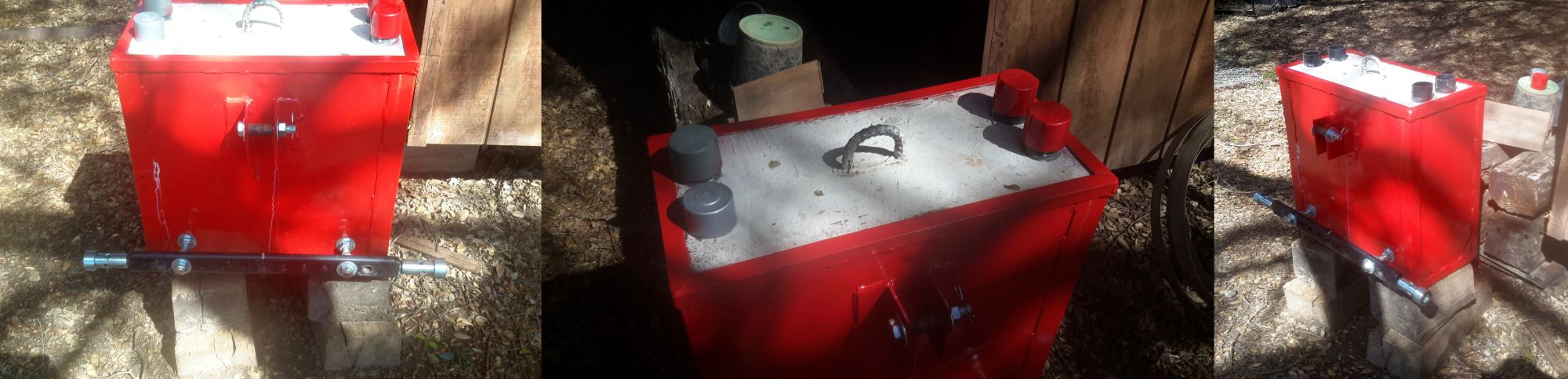

Just build one to match QH dimensions and your weight specifics... There is several threads on forum about ballast boxes... I just fabricated one out of scrap/scrounged materials and fill it with concrete....
Mine is about 600 pounds, and 2x2x1ft or 4 cubic feet, and concrete weighs in about 150lbs per cubic foot... But i have small SCUT and the 600lbs. (+/-) is sufficient for my needs...
You can probably can make one a lot cheaper than purchasing a box then having to fill it.... Many build plywood form, and just stick out attachment points and fill with concrete...

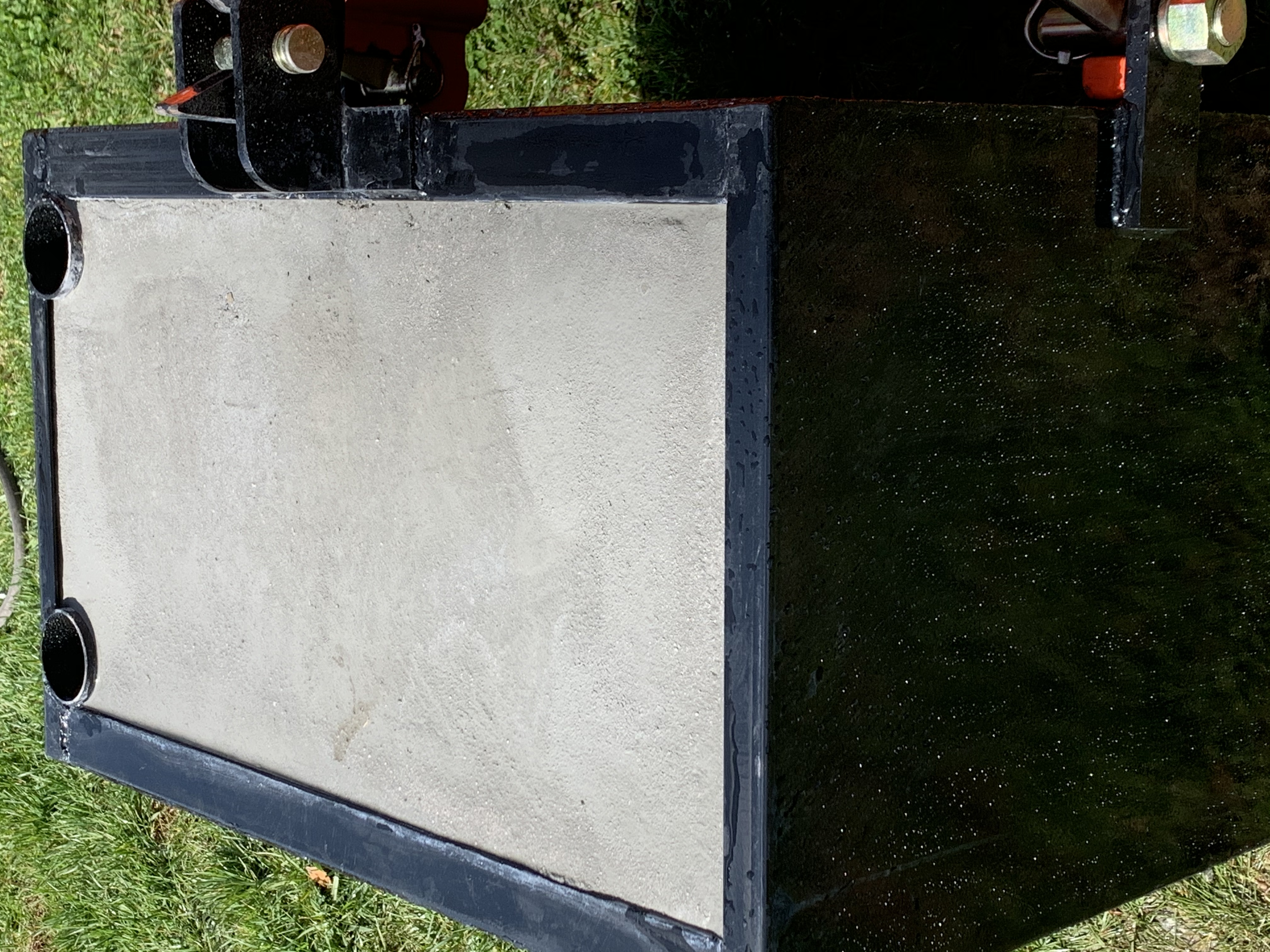

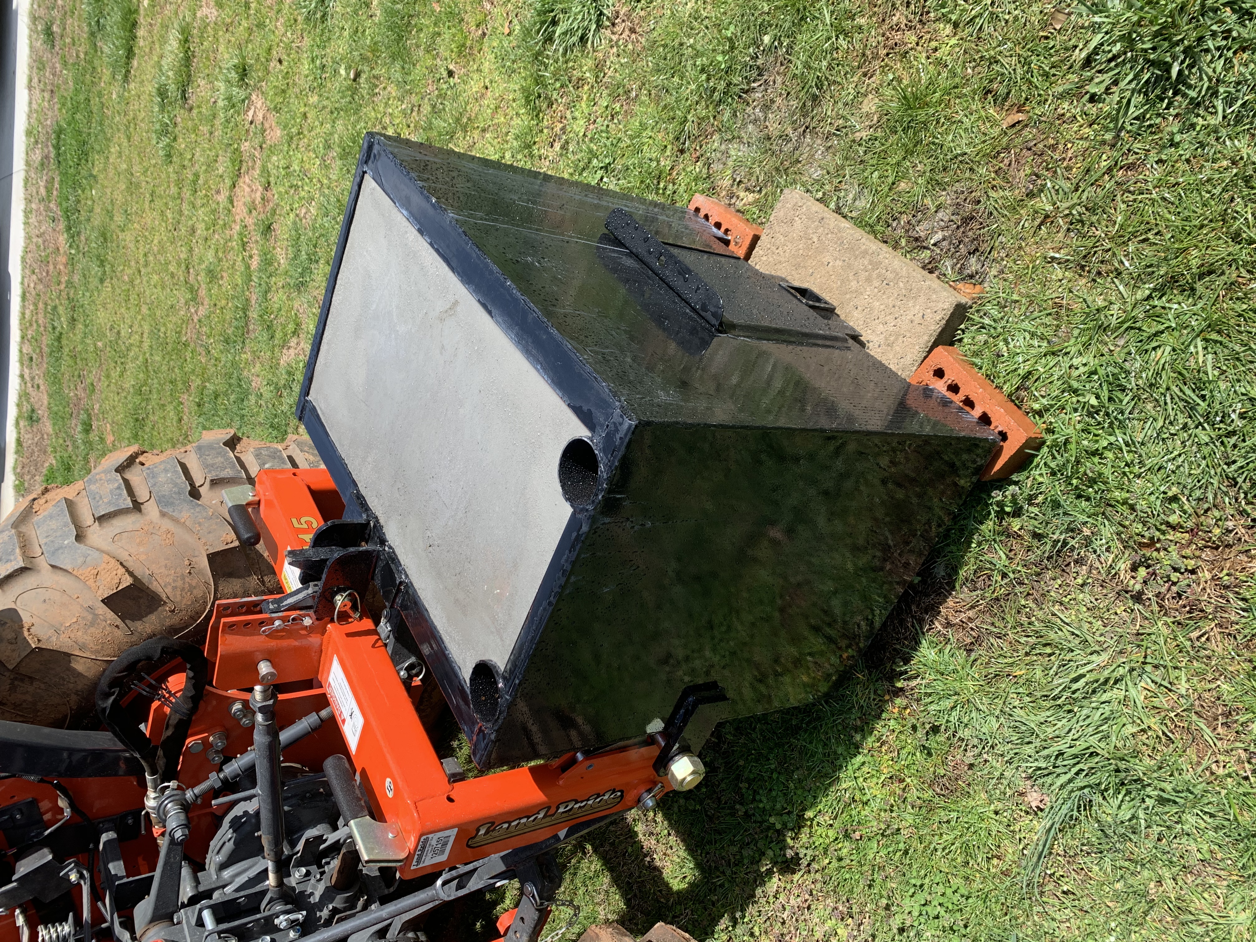

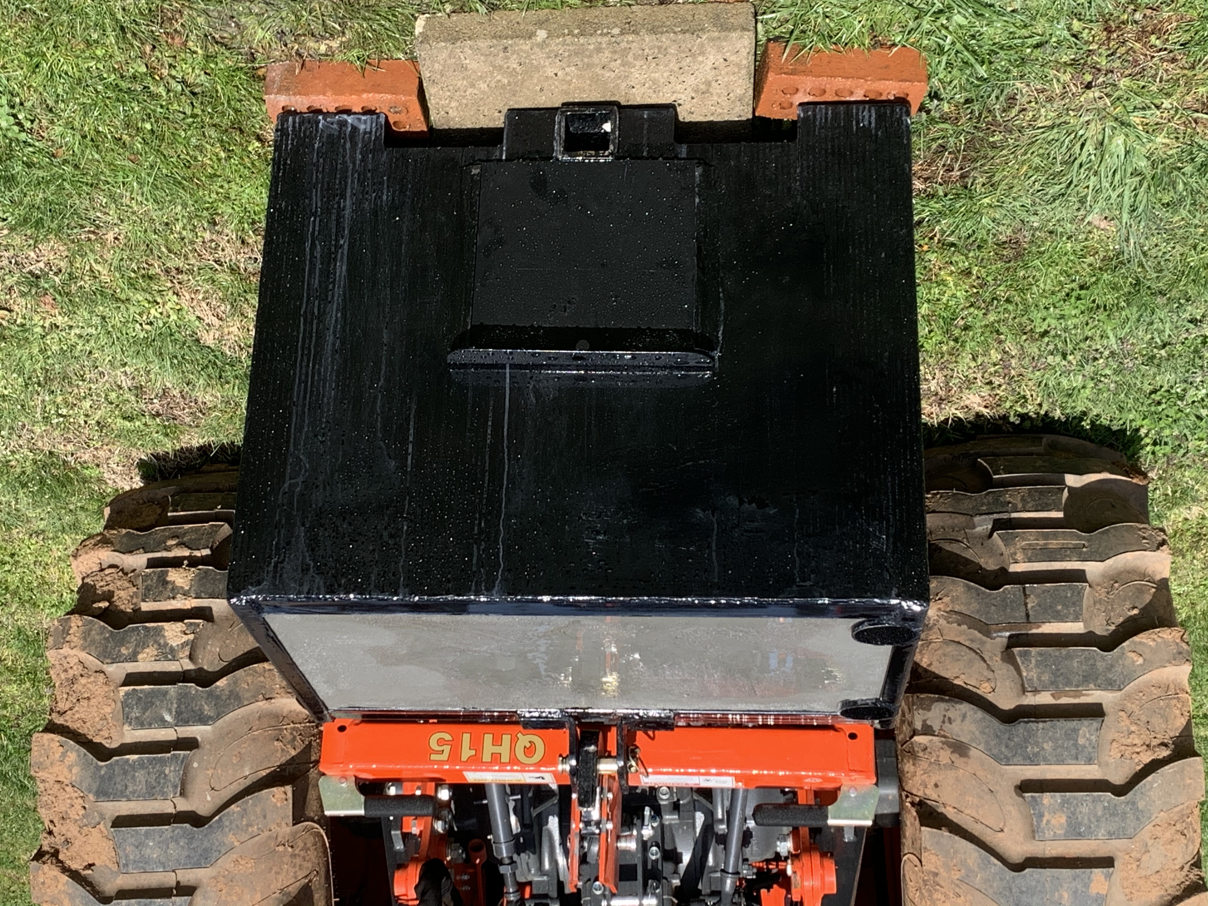

Well went with Titian Cat 2 ballast box like $420.00 bucks have the QH 15 hitch box needed just a little tweaking left bottom lift pins pointing in only way they would work for spacing on hitch.Had to grind a little on top edge of box where top hook on QH was just rubbing a little after that it痴 good to go !!! Box took 11 80lbs bags of concrete I知 estimating weight about 1170 lbs should be enough to ballast L4701 loader if not I値l go wheel weight or add bracket to box and hang suit case weights on ballast box.
