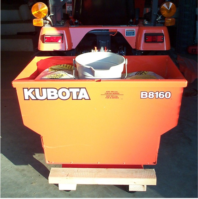

Here is a picture of my ballast box and dolly. The dolly is made from 2X4s and 4 casters (150 lb. Capacity each) that I bought at TSC. The total cost for the hardware was $27 and it took 1 hour to make. My box and the sand bags weigh about 400 pounds. It moves around easily on the dolly.
After reading F350Lawman’s post, I think I will add a couple of PVC tubes to carry rakes and shovels. I think I will be able to wedge them in along side the sandbags.

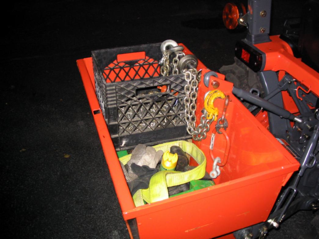

I have the Kubota ballast box, got it with my B7500, paid $150 for it. The wider shape makes it more handy to use as a storage box than the JD box that came with the 2210 I used to have. Also, it sticks out less in back, making it easy to maneuver, which is kind of the whole purpose of using a ballast box vs. an implement just for weight. Here is a picture of the inside, iron weights under, storage on top.

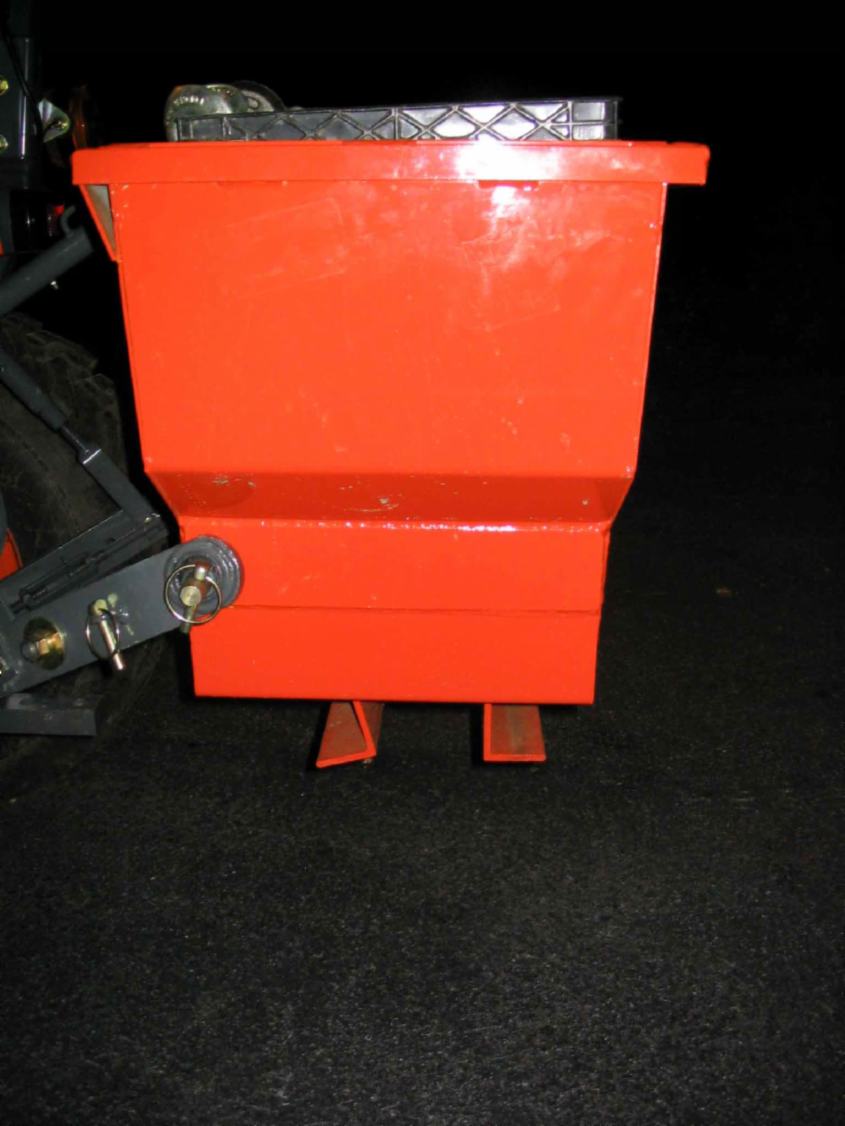

Now for the bad part. As you can see in this second picture, Kubota put angle iron legs on the bottom. Not bad in itself, but the front one acts as a "hook" of you are driving in rough terrain. It is now bent, making it stick down even more. This could have been avoided by welding the legs on with the open ends facing in toward each other.
