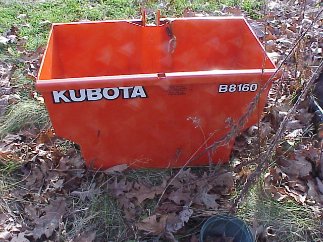

Hello,
I'm new to posting but have been reading these forums for a while. I've learned a lot in that period of time and I thank all of the posters.
The question I have is about ballast boxes. My father bought a Kubota BX24 a week ago for working on his property at his cottage. It was pretty cool that they delivered it on his 67th birthday. Never too late to buy your toys.
Anyways, a winter project that we have in mind is building a ballast box. I've read a lot of posts about these but what I really want is to build a replica of either the Kubota or John Deere box. So, if anybody could help me out with measurements it would be greatly appreciated. Maybe even a couple of pictures. I will post pictures during this project if anybody is interested in building their own.
Thanks,
Allan

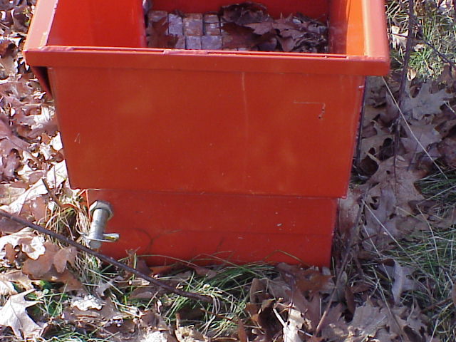

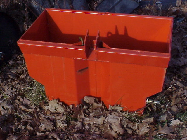

The Kubota box is 32" wide X 18 front to rear, and 19 high. I have no idea why they tapered the sides or what the indentation in the rear of the box is for. They used two pieces of steel on the bottom to hold it off the ground about 2" that cannot be seen in the pictures. I will take additional pictures once I put it on the tractor. This should be within the next week, since it is getting close to the time that the snowblower will need to be mounted. Let me know what other information you need and I will post it. Dusty

Thanks a lot for the info and pictures Dusty. They will definitely help me out. It looks pretty easy to build. Any idea on what gauge steel the sides are? I was thinking 12 gauge would be fine.
