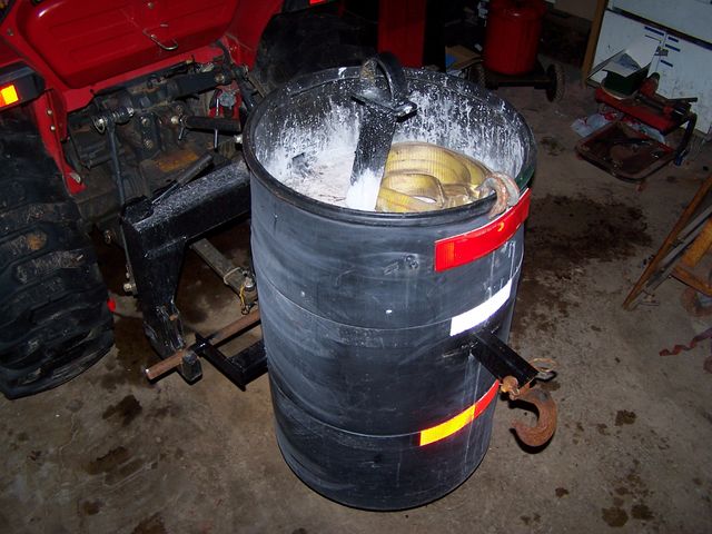

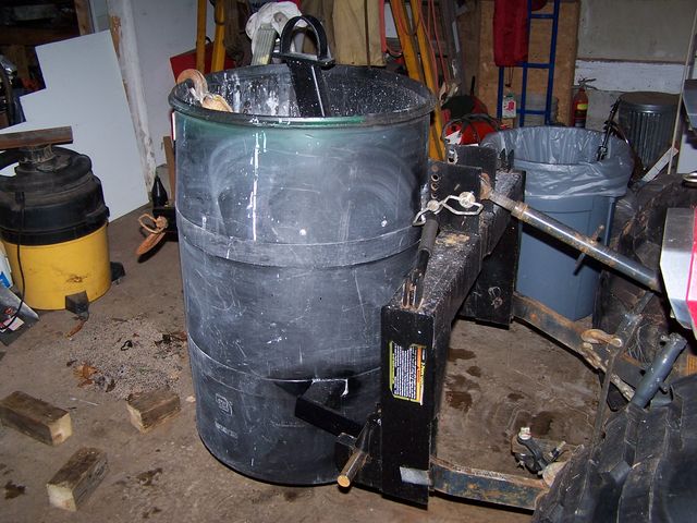

If you don't want to spend the big dollar you could build your own ballast box as many members have. Search for ballast box or rear ballast for the threads. Many have used the round barrel approach as did I. Others have made their own square box including another JD owner. I made mine out of a 55 gal plastic barrel with steel framework inside and cement for a total of under $50 and a rear weight of 800lb.
