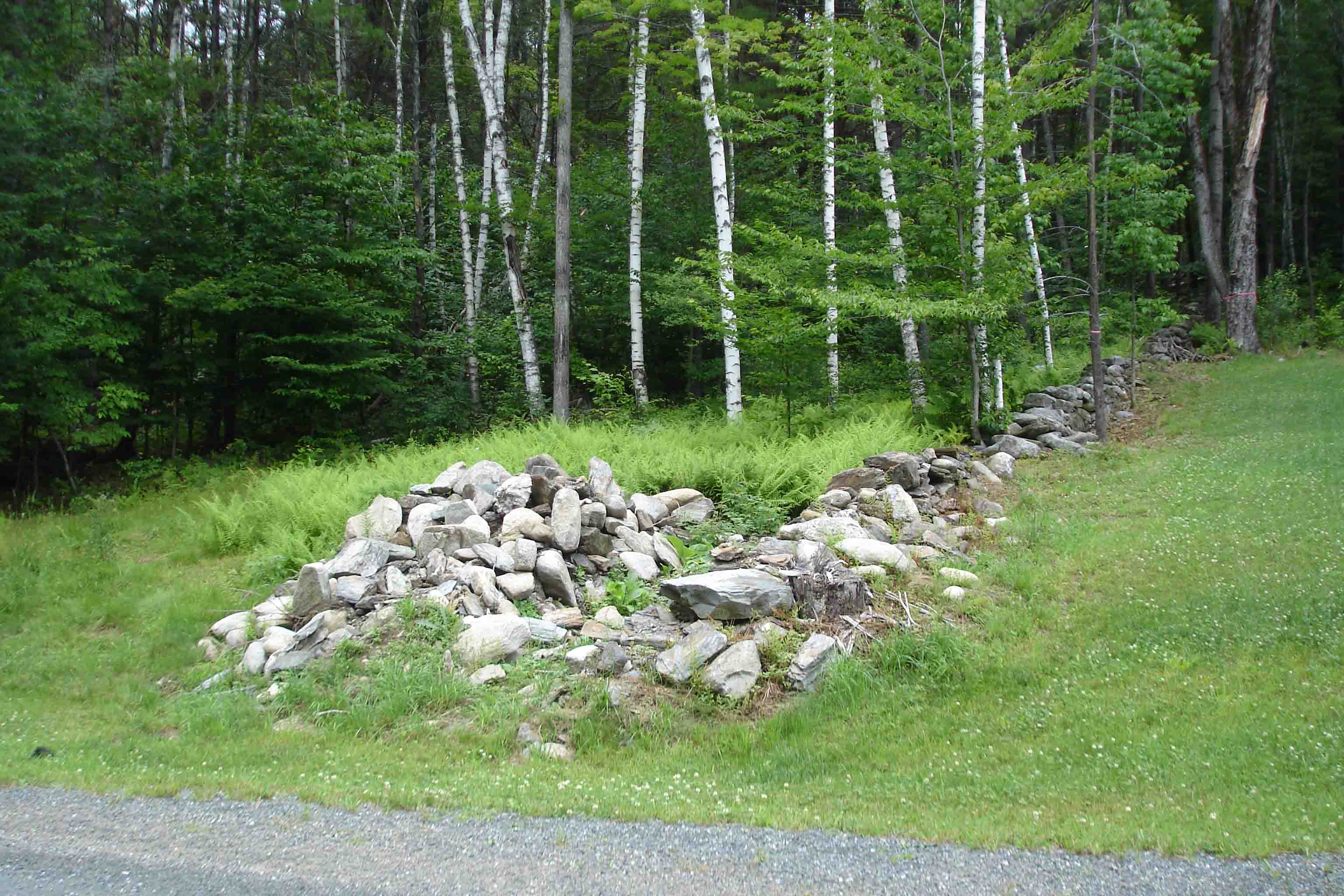

Thanks for your response. Here is one of the first things I want to do with this tractor:
These stones were displaced from a 200 year old wall when we cleared the land. I want to pick them up and rebuild the wall. We have hilly land and I can imagine that I may be on the edge of tipping. I certainly don't want to get near that point.

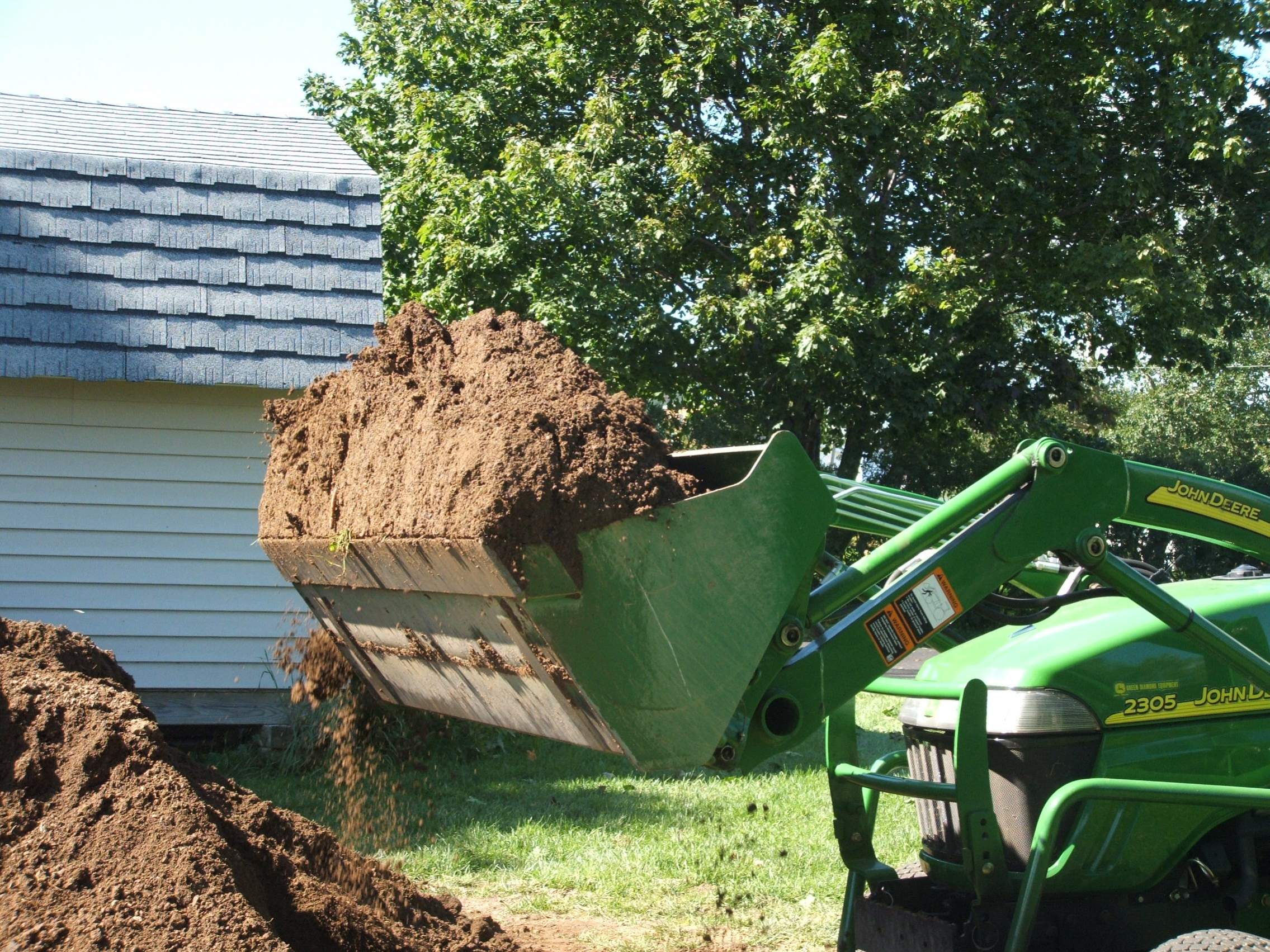

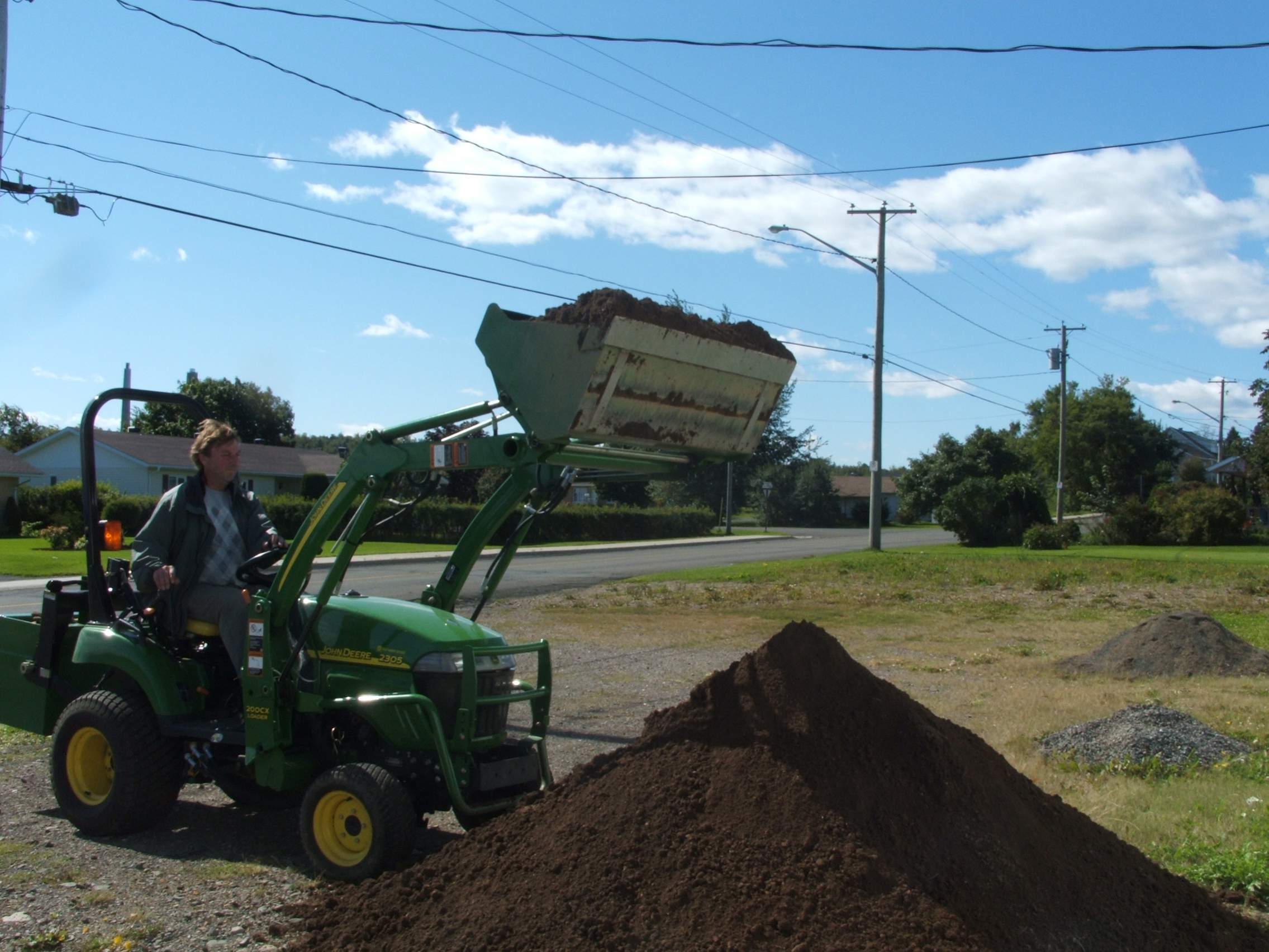

Agree with what most people are saying. A full ballast box will counter weight a full 200cx bucket on your 1025 and this is the way to go as it will off set the weight on your front axle. I would only recommend wheel weights or tires fill if you are working on a hill side for stability. Some people will fill them with windshield washer. Much cheaper.
