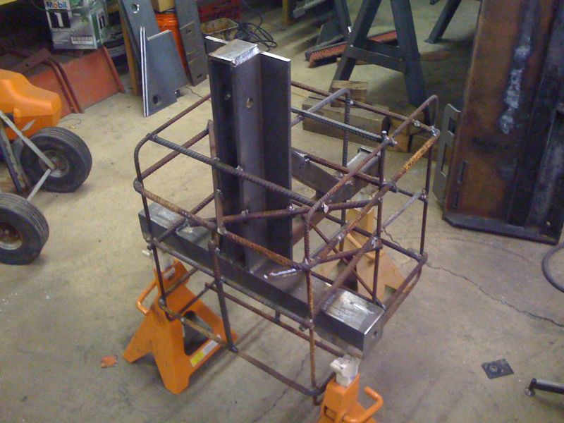

Decided it would be handy to have something a little more substantial and a little more compact than my Woods box blade for ballast ... so I decided to pour a concrete ballast block.
The dimensions are 22" (wide) x 24" (long) x 28" tall. With the steel used for the 3PH and rebar cage I figure it will weigh around 1100 lbs (15 bags of concrete - ten 60 lb bags of regular and five 80 lb bags of high-strength)
The 3PH assembly and rebar cage, almost completed:

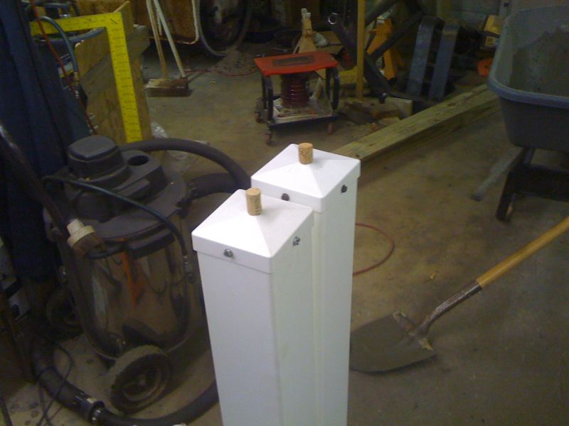

Wanted to add some capability for tool storage so I took a length of 5" x 5" vinyl fence post and cut two 37" long sections and capped them.
These were then drilled, plugged with wine bottle corks (to keep them off the very bottom of the block and provide drain holes), and inserted towards the rear of the block:

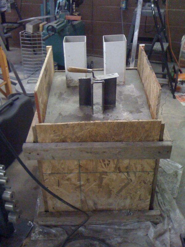

Here's the block the morning after I finished pouring it (about 3 or 4 days ago)
I used a needle scaler and several sections of steel bar stock as a vibrator, to consolidate the 'crete and pull out the air bubbles:
Not sure exactly how long I should leave the forms on ... I read of someone leaving them on a week ... probably a good idea in terms of keeping it covered to slow evaporation (I wetted the top and covered it in plastic after I took this photo)
Been keeping a fire going in the wood stove in the shed to prevent it from freezing ... although I'd imagine that the hydration process in something this sizeis generating a little heat on it's own.
