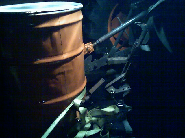

Finished my ballast barrel 2 weeks ago and tried it out this weekend clearing 30 inches of snow from neighbors road and parking area. Before had to be very careful with new tractor as I almost tipped over because bucket in the air and unstable base! :eek: I made a ballast barrel from 55 gal drum filled near top with concrete, approx. 800lbs. Much safer feeling now. Great traction, not much spin and no chains! I shoved the top half off and piled on sides of road. Pushed the rest to the end of road. Cant wait til next year, maybe I'll get a snow blower. :D
   / ballast barrel makes new tractor #2
Blagg,
Lets see some pics of that ballast and how you made it!
Sorry this is not the best picture, its dark. Started with a 55 gallon drum with a 7/8 rod about 30inches long up 9 inches from bottom offset to one side. Then took 2, 3/8 x 2 x 12" pieces with bar welded across end, poked through side of barrel for top link. Filled barrel with 13 60lb sacks of concrete. That filled it 3/4 full

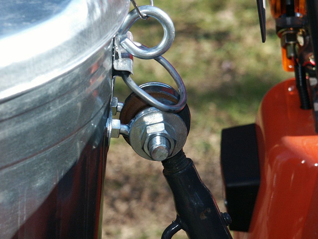

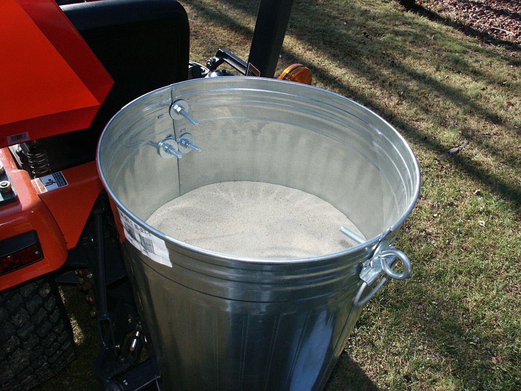

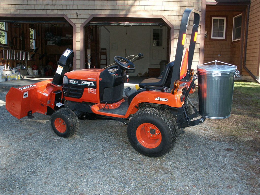

I've attached some pictures of a similar ballast barrel I made when I first got my tractor in 2003. I had it rigged with a removable top because I put dirt and sand in it to spread on the driveway when necessary. The bottom was just anchored to a crossbar using a bolt and rubber grommet to the center of the bar (because I wouldn't have wanted to lose a grain of sand out the bottom, ha!) I would put about 120 pounds in the barrel and could adjust the weight distribution by lifting or lowering the 3 pth. I have since replaced the barrel with a rear blade that I just keep on the tractor all winter. It's heavy enough to do the job and pushes snow, smoothes dirt, etc. much better than the modified trash can. Dyer, retired

blagg,
What is the strap at the bottom of the photo for?
