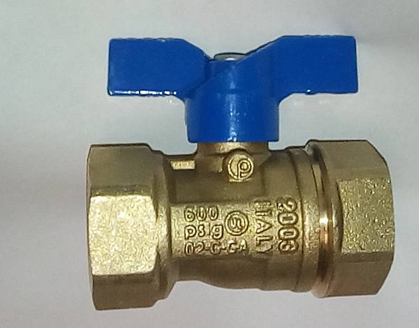

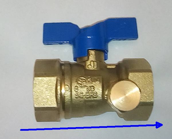

Arrived today. Stamp is 600 PSIG O2-G-Ga. Not sure what the 2003 is, part number, series, standard ... hope it isn't a MFG date ;-)
No flow direction marked, but I plan to set it with the arrow so the valve can be shut off to connect the tester if needed. If they never use it, I'm OK too.

Congratulations on the new valve! I know it has been a journey.
Unless it is marked with an arrow indicating flow, most ball valves are bidirectional. So, you are good to go.
