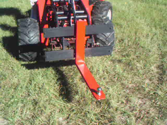

Here is the one on my fork.

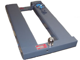

Here is another idea.

I'd say anything 1" back or more would be fine. The closer you get to the tip, the less force their is on the fork.
I'd feel better with a 1" hole at the tip than I would at the heel of the fork.
/ Ball mount on pallet forks #10
The hole on my forks is about 2-3" in. It works great but I should take the other fork off when moving trailers. The silver ball looks good on black forks.
