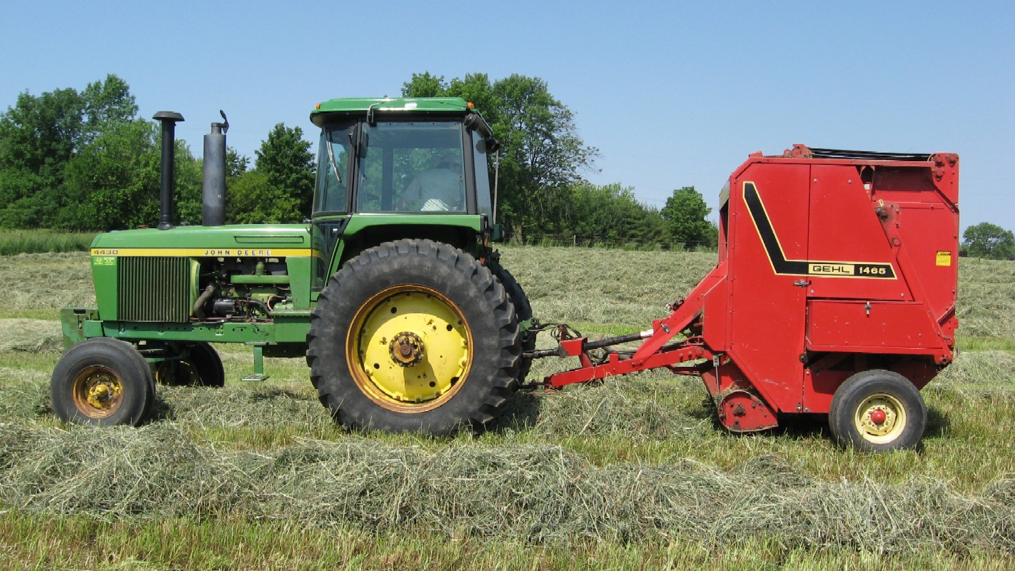

There is alot more tongue weight with a round baler than a small square. I can bale with my DK45 with 38 PTO on my NH315 baler and it will handle it. I haven't tried my Gehl 1465 round baler with it. I need to check what the weight might be with a bale in it. It is 4x5 bale. It is electric tie so the one set of remotes the DK45 has will work. I normally use th JD4430 as it has enough weight to handle both balers on hills etc. I have ran a NH 648 for a couple of years. I would rent it when I did rounds. It also made a 4x5 bale. I rented a NH658 once also. It made 4x6 bales. I really couldn't tell if it took more HP or not when compared to the Gehl 1465. I will say they both make a tight bale. Both were belt balers.
