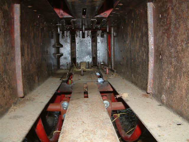

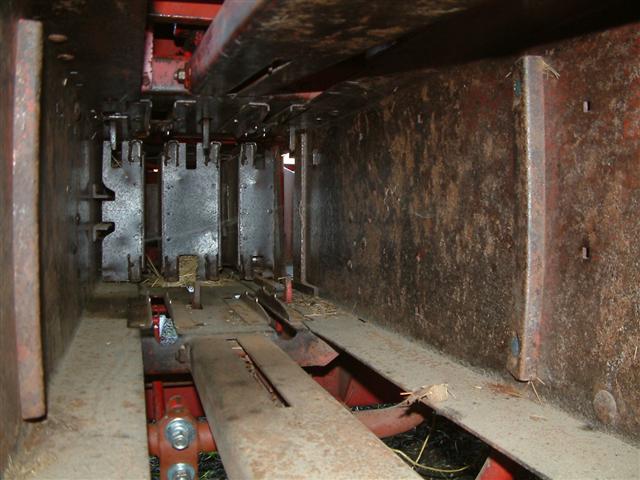

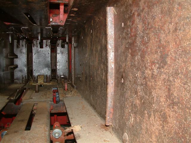

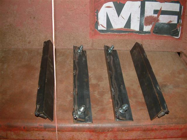

The spring-loaded hay checks (aka hay dogs) in my MF124 baler are on the top and bottom of the bale chamber (3 on top, 2 on the bottom). The wedges are installed in pairs on the side walls of the bale chamber, which is pre-drilled to accommodate 3 pairs of wedges. I use one pair of wedges for my oat hay. These wedges bolt onto the bale chamber side walls and are not spring loaded.
So, the "straw blocks" are the edge that the plunger knife cuts the oat straw or hay against.. You add or subtract wedges depending upon the material you're baling?
AKfish
Nope. The wedges install in the bale chamber 1-3ft downstream of the plunger knife. You can see one pair of wedges in these photos.

You can see the plunger knife, the two wedges I have installed now and the 5 spring-loaded hay checks in this photo.

The guy who sold me the baler couldn't find the other 2 pairs of wedges, so I welded up replacements.

Hmm... looks like the wedges function like a horizontal rail that support and/or keep the plunger head in postion.
But.. you said that they're 1-3 ft. downstream of the plunger? Maybe I'm not looking at the pics and seeing what I need to!!

These photos were taken from the output end of the baling chamber looking forward toward the business end of the plunger. These wedges have nothing to do with plunger operation. They just help restrain the compressed hay and keep it from unpacking while the plunger is cycling for another compression stroke. The hay checks in the top and bottom of the bale chamber also help keep the bale compressed while it's being formed.
