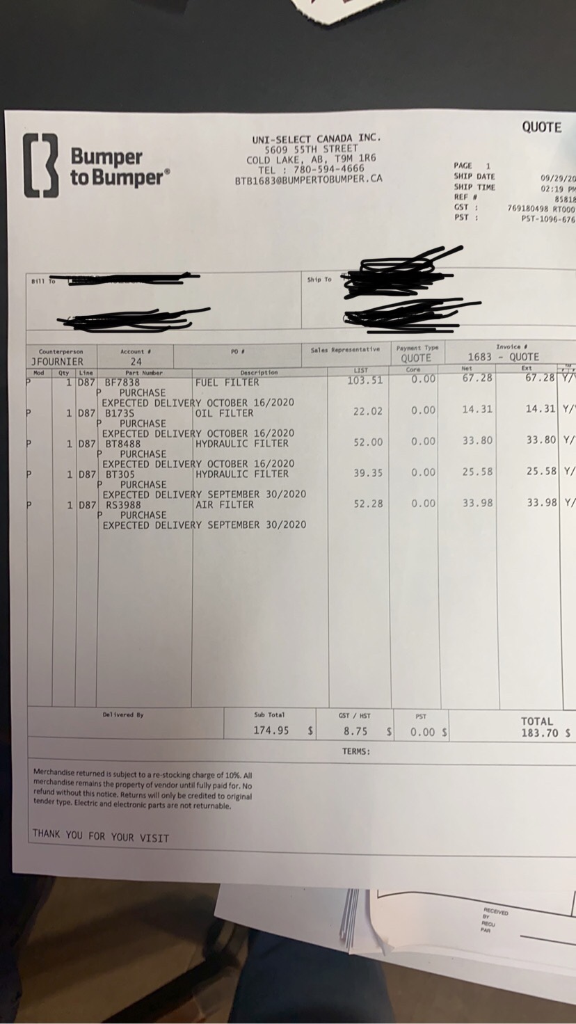

I have found this out so far with some searching not sure if correct numbers or not yet trying to confirm?? Attached is a pic of my factory filter numbers for my 2016 2610HST.
Hyd filter BT8488
HST filter BT26010
Oil filter ???
Fuel filter B1404 it lists about 15 more Baldwin’s too.
   / Baldwin filters
These are factory numbers from what I can tell
Oil filter E6200-32113
HYDRAULIC filter 2185-38031
Air filter T2198-11071
HST HYDRAULIC filter T2195-38031
FUEL filter T4682-43172

It seems like a lot of effort/time on your part looking for the Baldwin filter numbers.Why not buy filters from your local Kioti dealer?
   / Baldwin filters
Well as i said in first message the dealer is a good 1 hour drive one way so would like to get Baldwin filters cause I can get them in town a 10min drive.
   / Baldwin filters #9
It’s pretty simple. Use Baldwin cross reference info. If Baldwin does not provide a cross reference for your tractor, do not buy Baldwin filters for it.
   / Baldwin filters #10
You can also get Wix filters too. They are as good as the Baldwin. And they supply alot of the OEM filters to tractor manufacturers, and also handle US military orders for filters. Also all NAPA store filters are Wix, but NAPA use their own filter codes.
