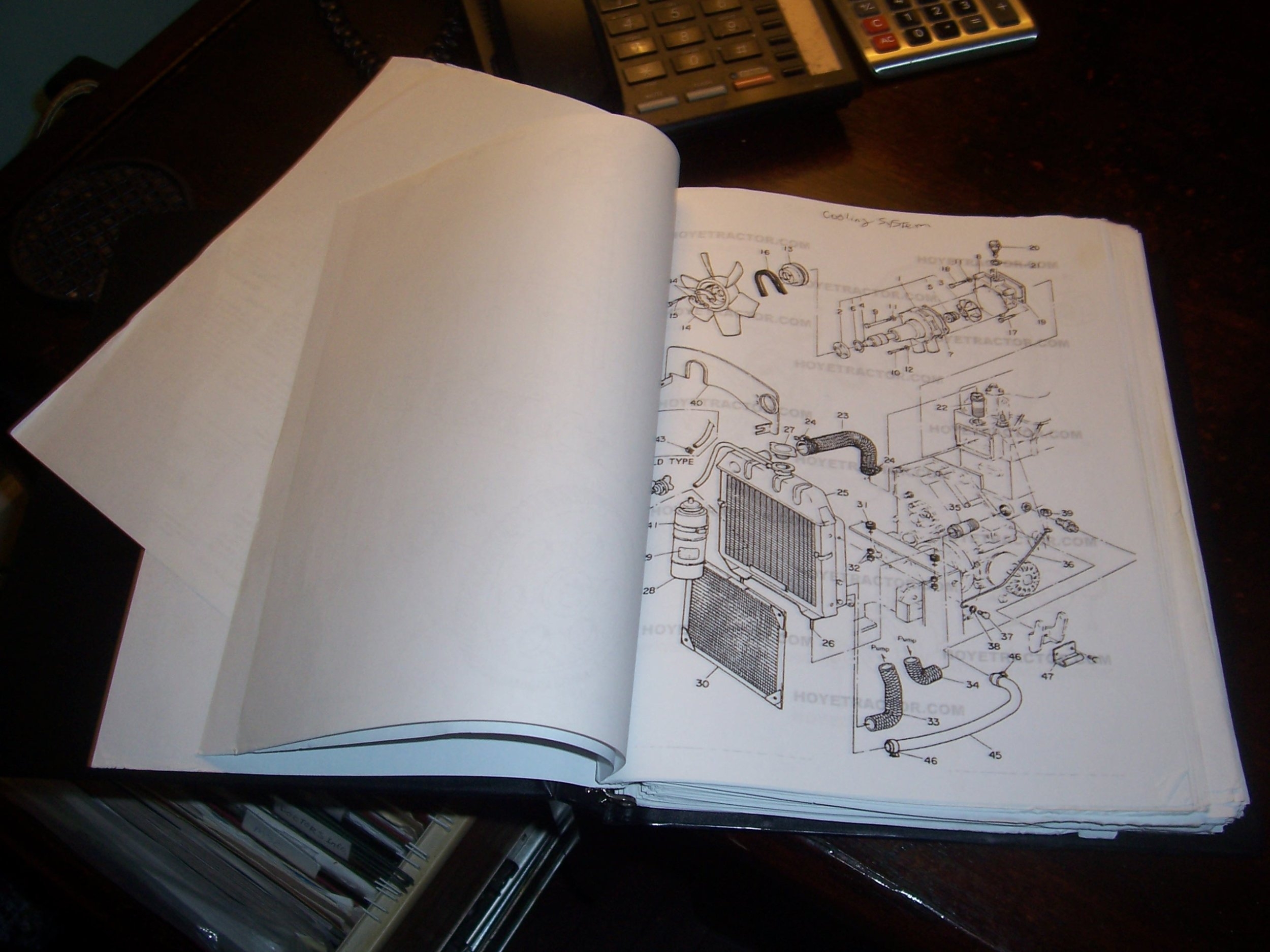

I have a 3 ring binder off all the Yanmar Org. part# and models that used them. Fredricks/Hoye. Also the Ym2000 Diagrams from Hoye which I posted on here before for people that may need to look back at them since there gone. Almost 20Yrs back I had it complied. Pretty much covers all the YM,F,FX series. Fredricks almost quit importing and just purchased the Org. YM2000 so it was in my best interest to have it.
