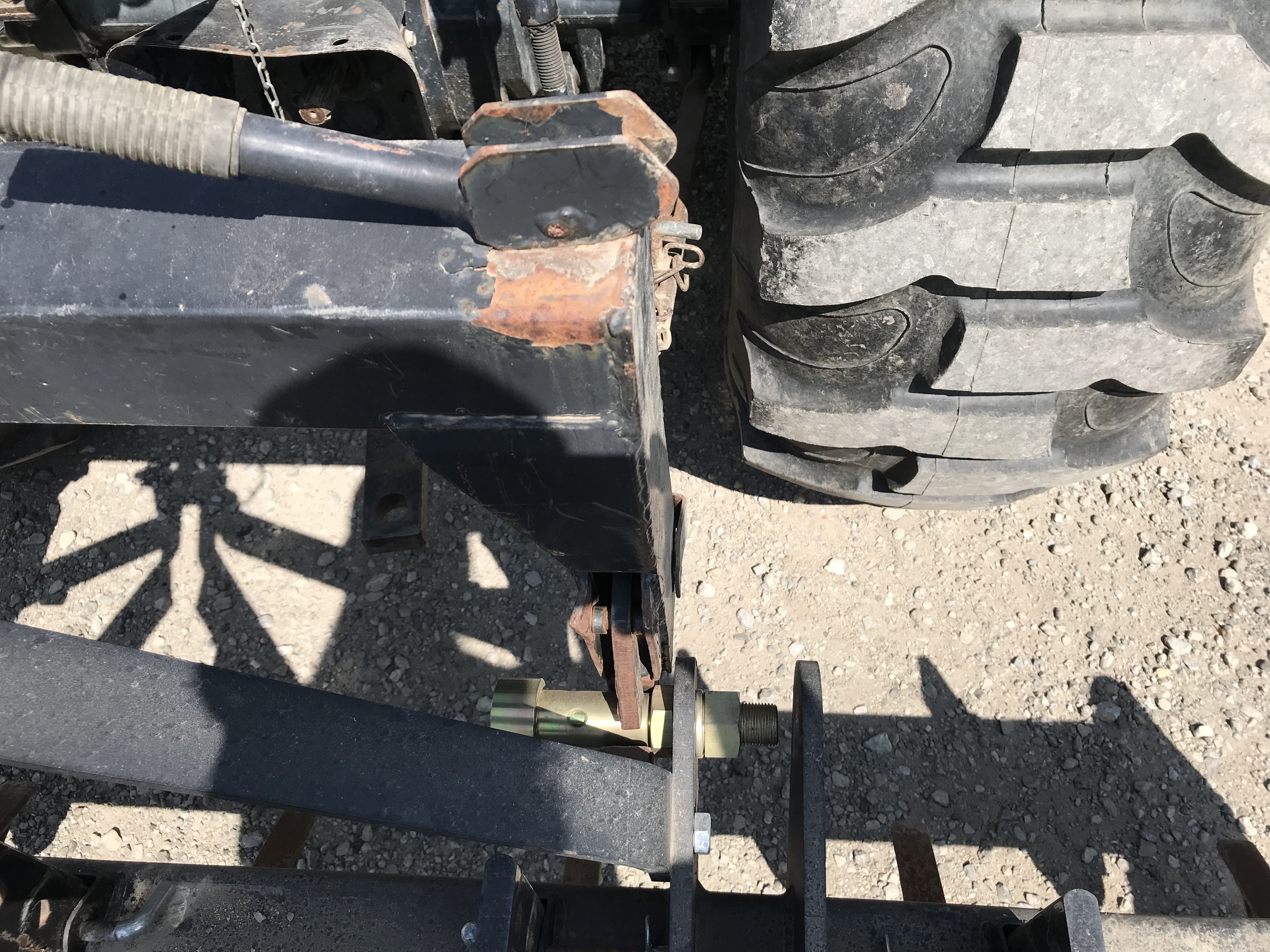

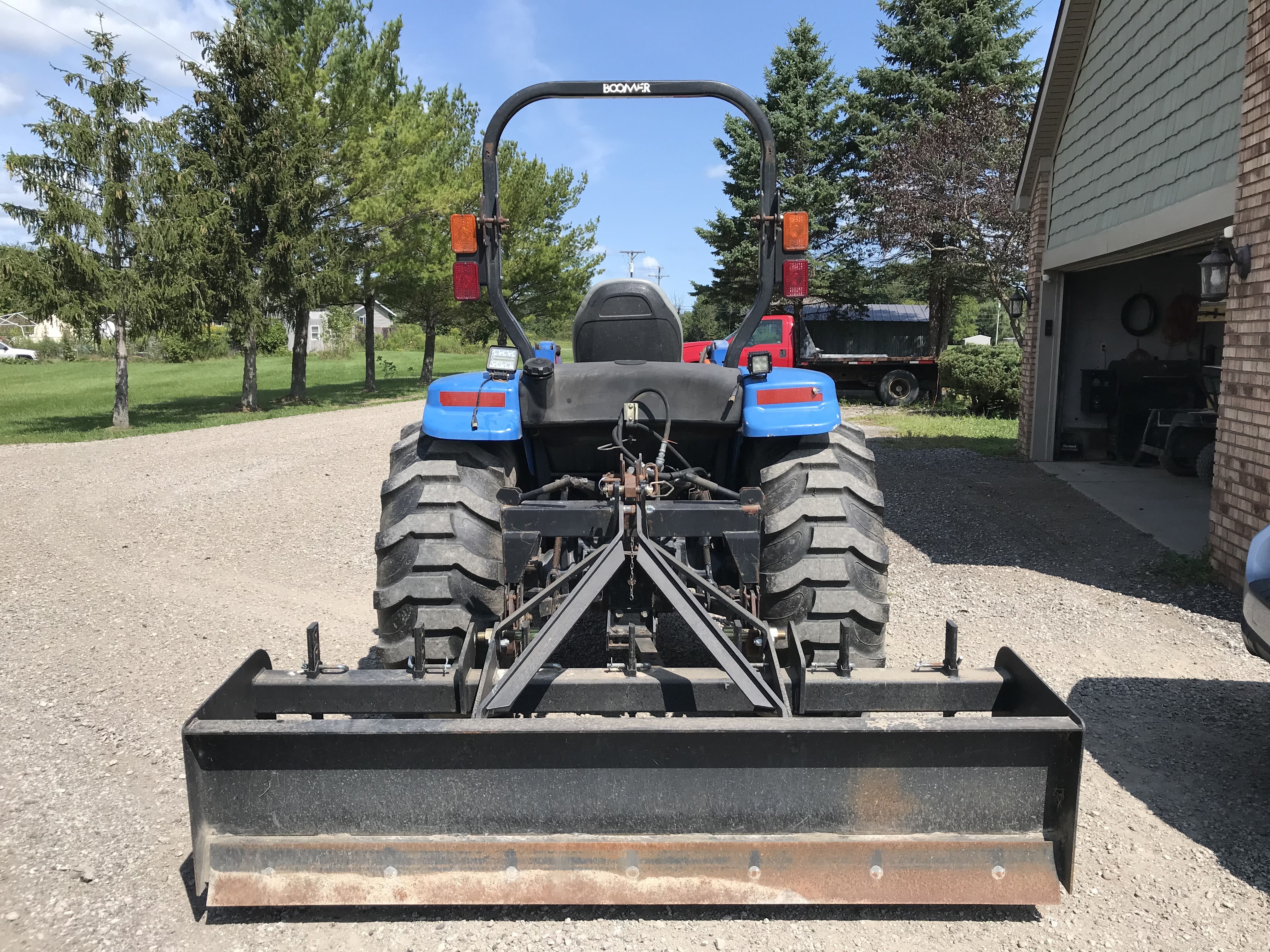

For anyone with a bad boy 7’ box blade. They really did make them cat 2 only. It’s super easy to make it work on cat 1. I have a nh tc45 I use it on for grading drives etc.
I used a pair of speeco cat 2 bolt in pins off Amazon. They are 1-1/8” thread. So they fit perfect in the pin holes. Cat 2-3 bushings for the quick hitch. I didn’t like the hook in the top so I used my home made link. Cut a bushing to make the pin fit tight in the box top link so it won’t chatter.
