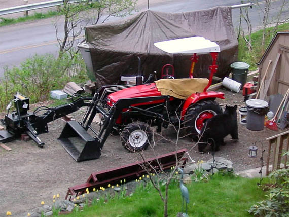

I am currently awaiting a dealer response. I have sent him scans of the relevant parts pages and a picture of the part in the tractor. I assume he is in contact with his counterpart in China. He doesn't like to email unless he has definite news.
I had the slight hope that he might find a matching part in the states, but I don't think that will happen. Meantime, I am having serious tractor withdrawal. If I could hide it away somewhere it would be better, but it is sitting in my driveway reminding me constantly. I am trying to find a place to rent to do the actual tear down work, as my mechanic frowned really hard when I talked about doing it in the gravel driveway. Problem is I don't know when the parts may show up. I am guessing October. I will probably have to rent a piece of equipment pretty soon to get my fix and also to complete the projects that I was working on when the Jinma hiccuped. I have been moving the 7 tons of gravel that I had delivered the day it quit with a wheelbarrow. Did I say I miss my tractor??
Jim
PS: I am attaching a picture of a bear that came to check out the tractor this spring.
