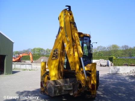

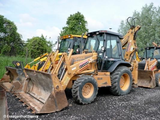

   / Backhoes: Side-shift VS Stabilizer #3
I noticed the European backhoes are like that and wondered why. Could it be for transportation resriction? are roads narrower than here?
I think the wider stance would be a big selling point. Must be a reason for the difference.
European Case and JCB
Good point there, our town street a very narrow because the are very old, many hundreds of years old. So maybe thats one of the issues why Euro Backhoe loaders uses Side-shift.
But all the tractor backhoe attachments are also side-shift, cant remember that i have ever seen any agri tractor with backhoe on a town construction site ever :)
One strange thing i have noticed is that the side-shift type has more bucket break out force then the center pivot type. As i mentioned the Mazzotti backhoe. The MAF 180 for tractors up to 30 HP, the MAF 180 side-shift has a break out force at 3970 Ibs - MAF 180 USA (center pivot) 2204 Ibs
The nardi backhoe: Side-shift 2890 Ibs Center pivot 2450 Ibs
The other specs as reach etc etc is the same.
And one of my main concerns is ground clearance, i will buy a 25-30 range tractor with R4 tires, with the euro style backhoe the ground clearance seems like be minimum.
Sorry for my english :)
