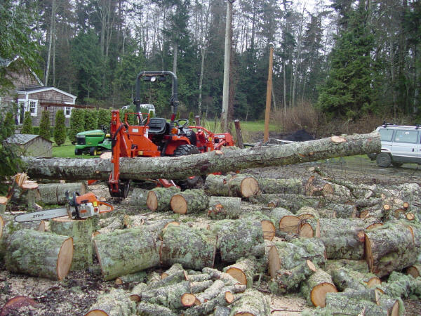

I have read a few posts lately where people were questioning the need for a BH. A few have even had salepeople try to talk them out of it. However, a few have had wives that wanted the BH and were pushing to get it. The same thing happened to me. I actually had a salesman tell me I didn't need a BH and my wife was insisting that I did. Once again..... it pays to listen to your wife. I have used my BH in a lot of different ways that I never thought of. This weekend I am dropping, bucking, splitting and palletizing 12 medium sized alder trees. Working on a downed tree can be a pain, and dangerous if you misread the stresses on the limbs. It's also a pain to cut halfway through the log and then have to roll it to finish the cut. After about the third tree I remembered that 800lb thing on the back of my tractor and started using it to lift the logs to work on. (See attached pic) Not only did this speed things up, but made the whole job safer and easier. Just thought I'd share this for any folks that are considering getting a BH. I know they are expensive, but the point I would like to make is that they can be used in a lot of ways that you don't think of, until you have one.

Looks like a great way to use the backhoe. Now, if you could replace the bucket with a wedge and stand the fire wood on end... you get the idea :grin:

Greg,
Great idea. I've used my backhoe mostly for transplanting shrubs and burying brush. I admit, it's a great piece of equipment. I think you've found another great use as well.
Just one precaution. Remember that anything being held by hydraulic pressure alone can release in an instant if pressure is lost anywhere in the system. I couldn't tell by your pic, but it might be a good idea to lift the log with the backhoe and then brace the log in position with some of those pieces on the ground.

Rick,
Thanks for pointing that out. However I have so much respect for those logs, I never put anything under them that I want back.... like a foot, leg or hand. I have seen some of these heavy logs make some unexpected moves and it's enough to make a real believer out of you. I just finished dropping the last tree and I learned as I went. I was pretty proficient with the hoe by the end. The biggest thing that I was worried about was the uneven load or torque on the loader bucket. I found that if I lifted the log high enough to put a block under the load just a couple of feet away from the bucket it eliminated that torque and actually made it easier cutting because it was more stable. I also found that I could lift the top of the tree and move it over to the wood pile before I cut it, so I wouldn't have to handle it twice. Now "all" I have left is splitting and stacking the 12 trees.............

I have the same setup as you. Although I've never used the BH to lift and hold logs I do use the FEL with toothbar to do that job. I may try the BH this summer and see if it works any better.

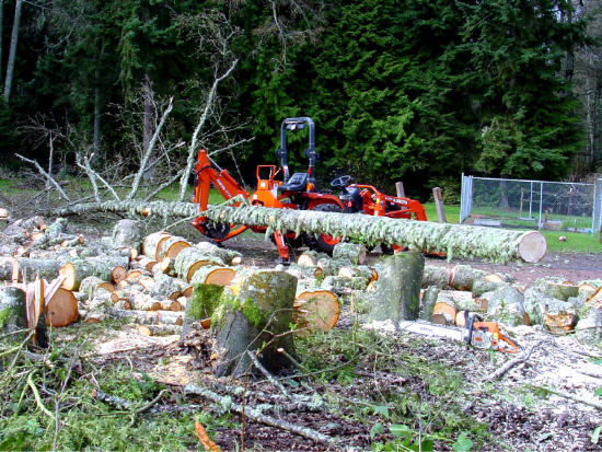

As I got a little more brave during the weekend, I ended up using the BH to move the top half of the trees over the wood pile, so I could buck it up right on top of all the other rounds. It was a little tricky, but with a good load in the loader and leaving the stabilizers down about 6" off the ground and the log balanced perfectly, I could move slowly in the direction of where I cut the bottom half and then use the BH to swing the log over the pile, set it at a comfortable height and buck it up right on top of the bottom half. (See attached pic) This saved a lot of work. I learned a lot this weekend.
